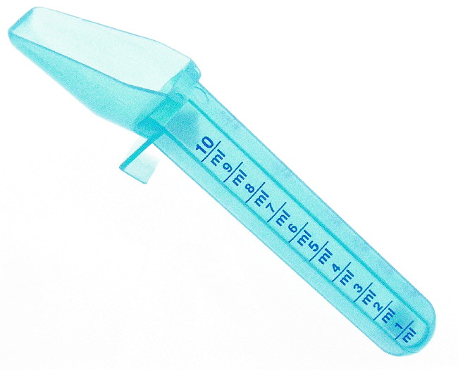

Another thing you can use besides a hypodermic syringe is a medicine spoon for babies (see below). It looks like a test tube and is marked in milliliters, but the end is flared like a spoon. I find it really handy for measuring small amounts of HC-110 or Rodinal.

Thank you very much for that measuring tool, but i think i will go with the syringe, in fact the syringe was effective without needle, so i will keep that way.

To measure the syrup, you can buy a Mortrain/Tylenol for kids in grocery store. It comes with a small measure cup with marks of 5ml, 7.5ml, 10ml, 12.5ml, 15ml. Perfect for the purpose.
