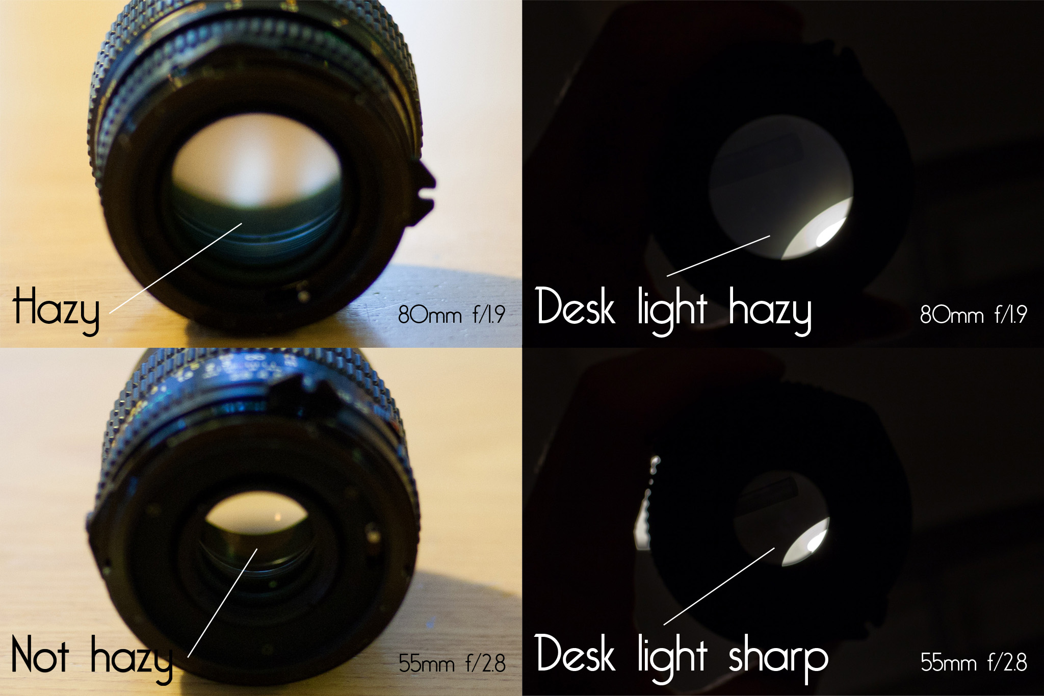

Hey all! I bought this lens a while ago but but didnt use it much and now I've realised there's some sort of light film on one of the back elements! Which causes this soft haze, emphasised by strong back light..
Anyway, I tried taking it apart but realised I couldn't get inside the actual glass lens elements, so I reassembled it (but did it wrong, that's another story!.. Focus doesn't quite hit infinity)
There's no way I could clean it myself is there? I've done a small amount of work on lenses before, I took apart my Canon EF 50mm f/1.4 and repaired that, but I couldn't unscrew the front bit of my 80 1.9, if that makes any sense to those of you who've done this before.

I had a similar issue, I ended up getting the lens back together, it took maybe 12 hours! Yep, every night for a few hours for maybe a week I would sit down study the mechanics of it and managed to get it completely apart and cleaned all the elements. Getting it fully apart is no easy task and I can't remember anymore how I did it. Repair is going to be expensive but you must get this lens back to life! It is the fastest MF lens ever made! You could always send it back to Mamiya or KEH for a clean/fix, for a few $ hundred....
Below was my drama re this lens, I eventually got her back into production (with the aperture working too) and have been thrilled since. There is some GREAT advice below....I wish you the best as this is a lens to get back into the field, the N is the best one too...

Hazing for mamiya 1.9 - it is a fatal defect.
It happens on N versions and could not be repared, because unlayering process in the rear optical element happens. I have one and i can not repair it.
