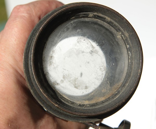

You need to really see the equipment, I bought a Dagor with a 10x8 camera that ws described as having separation/fungus, it was just 60+ years of accumulated dirt due to the ways it had been cleaned, in fact the lens was in great shape and coated :D
How would you describe this lens which I paid £20 ($31.50) for last year:
Oh and at least 3 spiders lived inside.

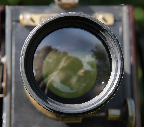

Reality:
The lens elements just needed a good clean which began with a wash in warm soapy water.
