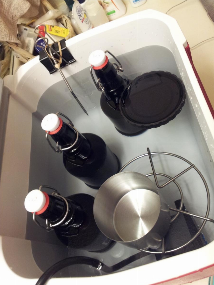

Here is the bath.
Keeping the temperature correct was no problem. All the rolls came out better than I could hope; at least as good as a pro lab (except for one where I stressed the film). The colors are right where I would expect for Provia (the warming filter does it a world of good). It is obvious that the agitation isn't overly critical and the time has a pretty generous leeway, considering the time to control the timer, empty and fill the tank, etc.
