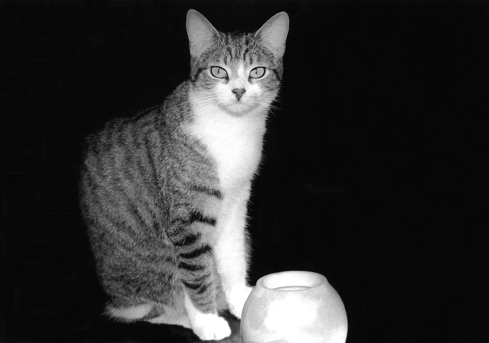

I use both my Metz flashes, the 44 MZ-2 and 54 MZ-3, on my M6 TTL and my Bessa R3A with both flashes set at either automatic or TTL and get wonderful images! Below is an example obtained with my 54 MZ-3 and my 50mm Summicron lens of our new cat.
