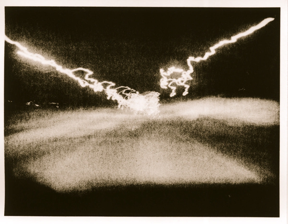

I get grain effect with lower contrast negatives; printing with the #5 filter really brings it out. Lith print even better:

I just printed 10x12" with maybe 1.2x crop from 35mm negative. I can now see the same lovely lith "speckles" on normal print. I'm in love. I've found The Grain.
edit: one of my IG lith prints has the speckles visible really nicely, I think (click the next image the IG post):
