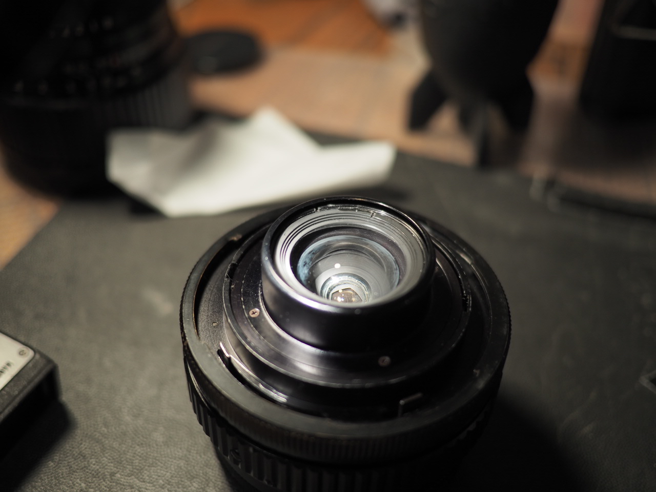

Here is a photo of the lens in question, aperture set to f/8. 8 is the maximum aperture, but I can twist the ring a half-click past the point where '8' is engraved on the ring. It pushes the blades wider by less than 1mm. There is no way to get the diaphragm to 'open up' completely. Does this seem right to anyone?

Mine is noticeably wider open with the pointer at "8" than yours is.
Check the entrance pupil's diameter. At f/8 it should be 65/8 = 8.13 mm, at f/11 it should be 5.9 mm. Hold the lens at arm's length, lay a ruler across the front, and see what you get. Don't measure the exit pupil, which is what your pictures show. Measure the entrance pupil.

I asked an eBay seller who was offering another 65/8 if the diaphragm on their lens behaved the same as the one in question, and they said that it did.
I have no experiential knowledge of large format lenses, but perhaps the ability to 'open up' the LF 'version' of the Fujinon SW is there as a creative option that was held back from the MF version, given the latter's original raison d'etre (tour group souvigner photography), where the possibility would just make your regular operations less foolproof. This is assuming that opening up the aperture past f/8 would significantly degrade the image quality in the periphery of the frame, which I think is pretty likely.
At this point I feel more confident that there is nothing too out of the ordinary with this lens' diaphragm.
Definitely going to measure it, too, though. And thanks for the instructions on how to do so.
