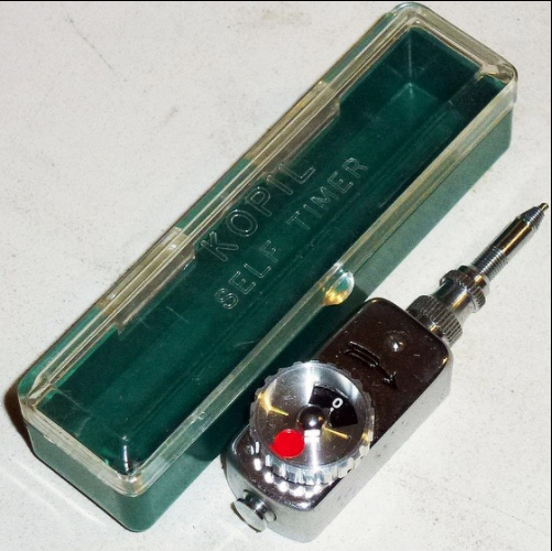

I have a separate self time to use with my Hasselblads, if I ever need one. It is like this one.
attachment.php
