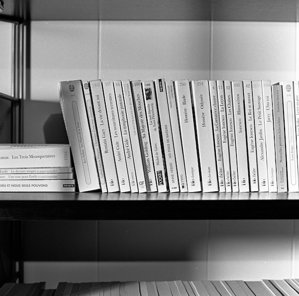

Hi David,
It is not that it is totally bad, but only bad in this respect.
As usuall it is more obvious in the side of the pictures, on the rail and uper tablet on this one. This might not be the best example for now, but not many are scanned yet.
I print up to 20x20
Again maybee I am picky but my eye react a lot to this, I always notice distorsion when I see pictures, will other notice it on my own pics? Don'T know but I certainly do.

Sorry Kris, I just don't see it and think you are worrying about nothing.

I see very little distortion here, as well. When the axis of the lens is not closely perpendicular to the "lines" in the composition, there will be *some* so-called wide-angle "falling away" of the extremities of the image. This is the nature of the beast - and,truthfully if my attention had not been drawn to critical examination of parallel edges here, I would never have noticed anything like that.
From what I read here, I would question the "fairness" of your evaluation. Try a few more exposures with both lenses, keeping both in the same position - perpendicular to vertical lines and deviating from perpendicularity equally, and compare the results.

I too don't see where you detected that distortion.
Perspective, yes. But distortion? Not in that picture.
But before you decide to do anything, put your camera perpendicular (use a mirror to align the thing) to a flat surface bearing absolutely straight lines, and take pictures. Examine and measure those.
Do the same with your Tessar, if you still have it.
And compare.
(Tessars, by the way, are not better lenses than these Planars. Their distortion is opposite, but about the same degree.)
It looks like the camera is slightly tilted to the left. If you look at the vertical at the right edge, it's not equal at the top & bottom of the frame. When you look at the left edge it may give the appearance of distortion because the vertical nearest the L edge seems to tilt inward.

Tthe example in this photo appears to show convergence, not lens distortion. Be more careful of having the film plane parallel to the center of your photo. The reality is that if you want perfect perspective control, you need to use a shift lens or go to a view camera with movements.

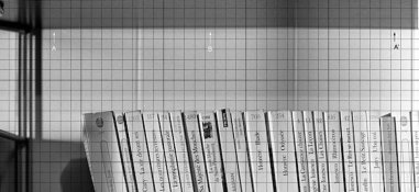

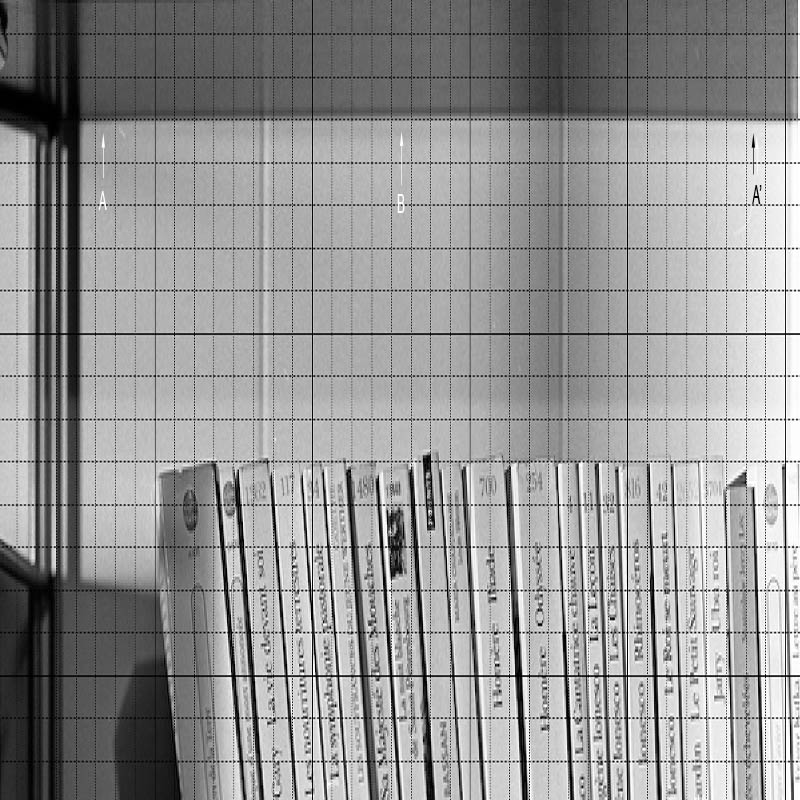

I hope the OP does not mind I used a crop of his picture to show the distortion. I superimposed a grid (I had to rotate the image 0.2 deg counterclocwise to align the grid) and you can see that in points A & A' the upper line touches the grid and there is a white space in point B. In the second picture I intentionally resized the crop changing the aspect ratio, to exagerate the vertical dimension, and the distortion becomes more visible.
As I said before it is very small but not unexistant. Check the technical data sheet in the Zeiss web page. The distortion (barrel) is more than 1.5% at the edges. It is not zero, The Planar 100 has almost nothing, the biogon 38 also has much less (but complex).
Francisco

I agree with fdisilvestro, there is some barrel distortion causing curvature of field there. That said, the CF lens is no slouch, the CB lens is even worse, and the 100mm planar is where there is virtually no distortion. I think we all know that the 80mm CT and CF lenses are not the best in the zeiss line up, but unless doing architectural or scientific shots, it's really of no consequence. It would also be an idea to list the aperture at which these images were taken. I find that the 80mm planar does it's best around f8 through f16 and falls off either side of that.
To me, there appears indeed to be some distortion on that line on top of the picture. But ... that frame, or whatever that is on the left, seems to be pretty straight ... strange. Are you sure that the shelfboard is not bent ?

And, just wondering, are you sure that the upper book shelf, in the first picture, is not bented by the weight of the books on it, who are unevenly displayed? Perhaps, the wood is bented due to climatological influence, out of you control and knowledge of course...
What I want to say is, that this kind of 'tests' should be performed with a controlled target and be repeatable, just to be certain.

This could also be caused by the film not being perfectly flat in the negative carrier - unless you are using a glass carrier most films will bend slightly causing this same effect.
"Are you sure that the shelfboard is not bent ?"
Indeed, this was also my first intention when I saw the example picture.
I think it will need a more serious method to determine lens distortion.

I could question a great deal of the conclusion that there is X amount of "distortion", for example:
"Three points (white) are not aligned in an image overlayed by a grid in PhotoShop....:
1. How accurate IS the PhotoShop grid? Are we assuming 1%, 0.5%, 0.001% - or what? Does PhotoShop specify the limits of accuracy?
2. Where did the "white points" originate? Were they artifacts applied to the background with great accuracy
(... how?) and recorded on the negative?
3. There must have been a scan involved. I know for a fact that the scans from my HP 1310(?) exhibit distortion, comparing file images to the original. I can't remeber ever seeing a tolerance applicable to this distortion, yet I would never, absolutey never, rely on a scan from this thing to "test" a lens - for any parameter.
Now, Hasselblad/ Zeiss claim "No more than 1.5% distortion" ... and that is what it seems to be. They have met their claim, done what they were supposed to do. Why is that cause for complaint?
