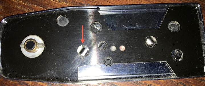

bdial
Jan 2, 2005
7,516
North East U.S.
On mine the short was at the terminal nearest the cover lock, marked with an arrow in this pic.
I verified that it was shorted by using a multi meter. You need to press down on the terminal fairly hard with the meter's test lead (as if the cover is locked into place with a battery pressing on the terminal).
On my camera the short did not prevent the camera from functioning while the battery at that position still had some charge. My fix was to use a paper punch to make some small vinyl circles which I slipped under the terminal.
Even though the other terminals didn't show any problem I put vinyl under all of them.
The foam that's under the black plate is fairly soft, and the ends of the terminals are kind of pointed, so after a while the terminal punches through the foam and you get a short circuit. In general, we all think highly of Hasselblad but it seems they made some poor design choices here (IMHO).

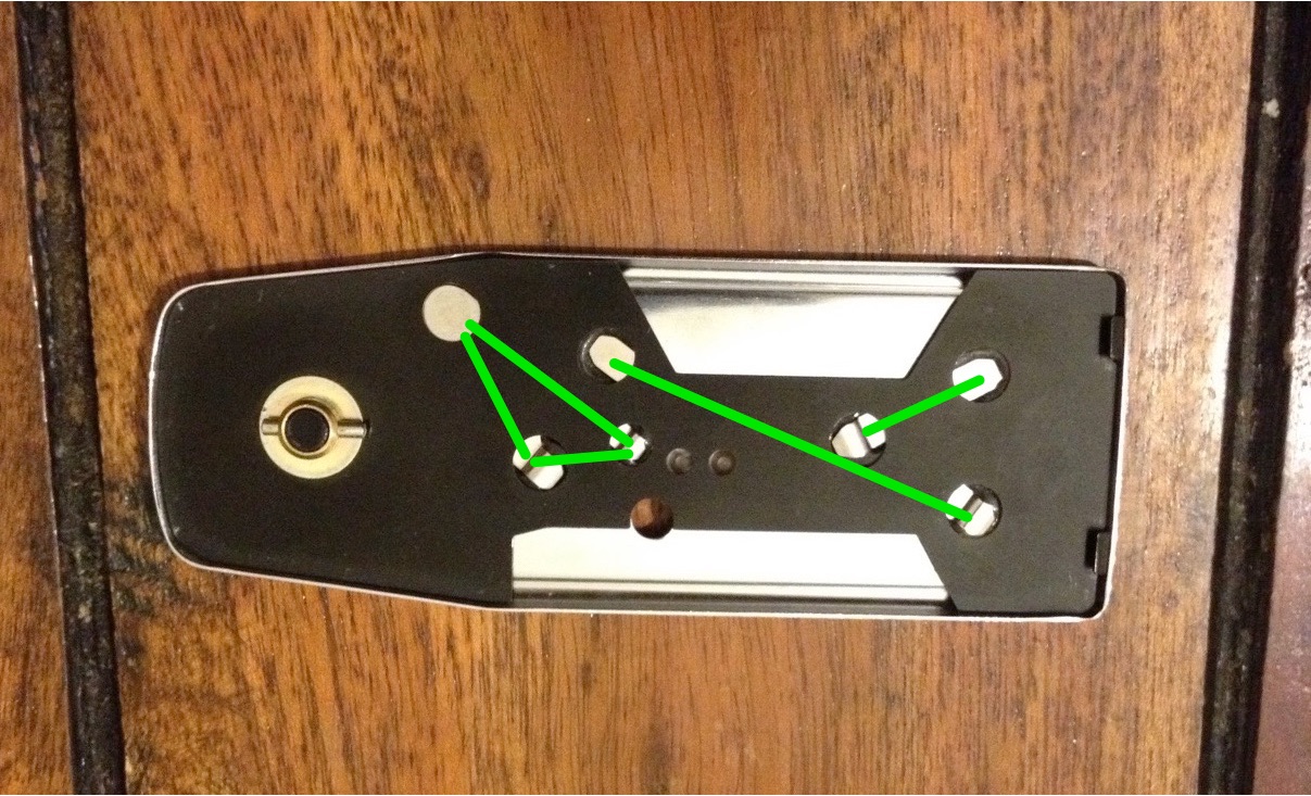

Hello Parker and Barry,
Here is an image of my cover plate with where I find the contacts are short-circuited (beep with continuity check), illustrated with a green line, including the contact for the fuse and contact for the little yellow dot sitting between the batteries. All other contacts connection are not.
Please let me know if these are indeed the problem. Its puzzling to me because this cover plate works on another 553ELX, however when putting on my camera the batteries do get warm, and of course doesn't work. So I start to think the problem might be elsewhere,
Did you ever figure this out? I would suggest anyone with an ELX take BDIAL's advice and add extra insulation under the contacts. I don't think it's a matter of if it will fail, but when.
