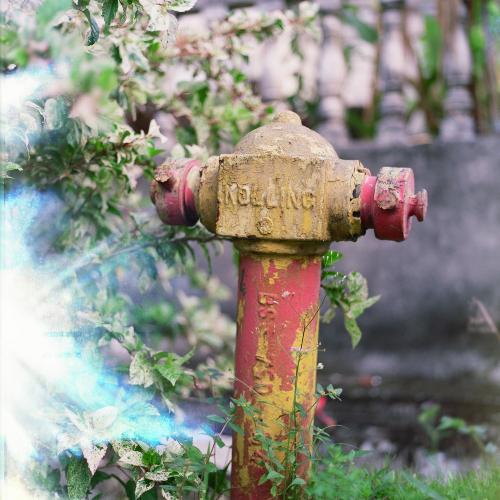

I just bought a Hasselblad 500Cm a couple days ago, and this is my first test roll with the camera. However, I had this in most of the negatives, eg. in the attached image.
Is this a tell-tale sign of a light leak in the A12 magazine? Sorry, if this is a common question as I'm very new to the V series Hassy.

Thanks, will do order one ASAP. Just one more thing, the light leak is prominent on the left side. However, there are also negatives that show the leak appearing on the right hand side. Is this the normal light leak or something worse?

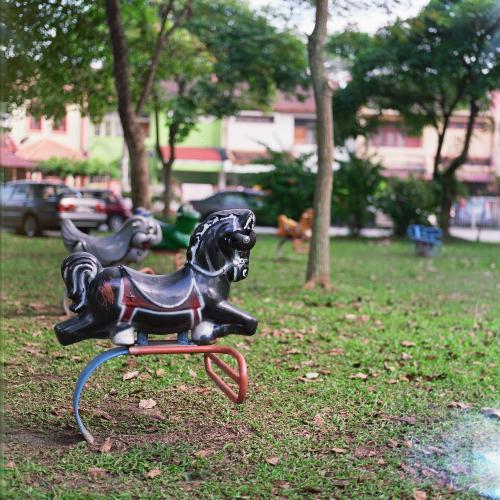

Example is attached, where the leak appears on the right instead of the left.

Light leaks on the opposite side to where the darkslide comes in could be something else, but my guess is that once light gets in, it can be reflected around. That said, your last image does not show the typical Left hand side flare either. I'd still change the light trap as an insurance policy. If you still get problems, then there must be another hole somewhere where it's getting in. Is there a way to show us a scan of the whole film area including the film rebates?? How old is the back also?

Yes, it is a light leak. Your back needs new seals. You can order them from a number of places including David Odessa or you can get them installed locally [but you have to lets us know where your are].

Is there any significant movement of the back on the body? That might also cause a light leak - see also (there was a url link here which no longer exists)
Flip your images upside down to determine where the leaks might reside in your camera. This is the orientation of the image at the film plane as viewed from the back of your camera. The light marks for the fire hydrant picture are on the side of the camera opposite where you insert your darkside. The light marks on the play ground image are above and below the darkside insertion area. Unless the play ground image was somehow inverted prior to being presented to us, you must have light leaks on both sides of the camera back. Interesting indeed.
Should I hazard a guess, the film backing paper was probably loose on the spool at some point. Most likely, that the film was loaded/unloaded in bright light and that the film was allowed to become loose on the spool prior to inserting/removing the film insert.

I personally do not think the fogging here reached the film through the DS light trap! This effect is easily caused by "fumble fingers" when loading or unloading.
It would be much easier diagnose if you had posted the negative strips them selves.

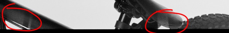

I'll be interested to hear if you solve these leaks. It's that second picture you posted with the leak on the bottom right that interests me. I had something similar recently, happening in the exact same place consistently, but leaks also occurred towards the center of the bottom of the frame. I'll attach a sample of a close crop. Oddly, there was on a few frames a dark line too running along the bottom of the frame (you can barely see it in this attachment).
The first thing I did when I saw it was go outside and test the 4 backs I used. Shot rolls with the lens cap on in strong sun. Two displayed classic leaking when the slide was taken in and out in open sun. But I was not able to recreate the bleeding on the bottom of the frame. Huh, right? Anyway, I'm replacing foam on them to be sure.
Then shoot keeping track of rolls to backs. So if occurs again, to see if I can catch the bad back.
Anyway, let me know if you come up with any solution.

Charlie, is right when he said that the leaks could be from my fumbling when loading the film. The second and third test rolls from the back are perfect and show no signs at all of light leaking through. So far so good.

Thanks for the pointers guys... I think it was beginner's error on my part. As I said before, the 2nd and 3rd rolls from the back were fine even before I installed the new seals. And so far I have taken more than 10 rolls with the same back without much problems. But thanks for the reminders on what to look out for. Appreciate it.
