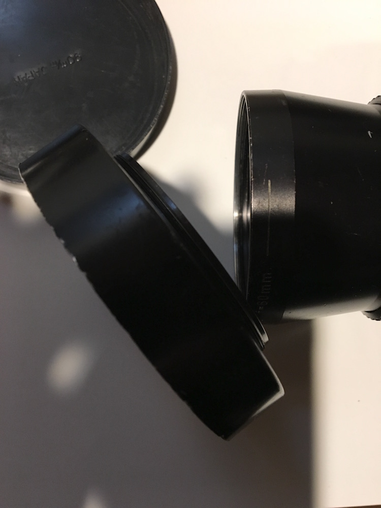

I recently acquired a Carl Zeiss Distagon 60mm f5.6 C lens in a Hasselblad auction lot of equipment. Turns out this particular lens is quite rare. It is in excellent condition and functions flawlessly. However, the lens hood (Hasselblad) is stuck on the lens. I am pretty strong but I cannot budge it. For all I know it has been on the lens since 1959, the year the lens was made. The lens shows very little wear.

Any suggestions from the experts here on how to get this hood unscrewed?

1st attempt I would get a rubber strap wrench Dead Link Removed and place it at the rear of the hood and give it a go. If the lens barrel wants to unscrew a second strap wrench on the lens barrel turning the opposite direction will help. Uneven pressure makes filters and hoods hard to remove.
2nd attempt I would get some Penetrating Oil https://www.amazon.com/LIQUID-WRENC...d=1497039423&sr=8-12&keywords=penetrating+oil and put a light amount around the filter to lens mating area as shown in your picture # 2 and let it sit for several hours to a day.
Other possibilities are heat the oven to 250°F (or its lowest setting) then turn it off when it reaches temperature, put the lens in the center of the oven, close the door, and leave it for 15 to 30 minutes, remove and allow to cool to touch (it will be hot to the touch) and try to unscrew while warm.
Put it in a saleable plastic bag, put it in the freezer for an hour or two, remove and allow to warm to touch then try to unscrew it.
Even pressure while trying to unscrew it is essential.

I want to thank everyone for their suggestions, all were great. I did get the lens hood off . . . I decided to start with the least aggressive measure . . Lighter Fluid . . . as suggested by Johnkpap before moving to the next.
Lighter Fluid did the trick!! Tried a couple drops earlier today, no luck. Just tried lighter fluid again . . this time I flooded the joint where the hood meets the lens all around the perimeter . . came right off with moderate force. Very happy because I like to use a yellow filter for landscape shots in B&W. :smile:
