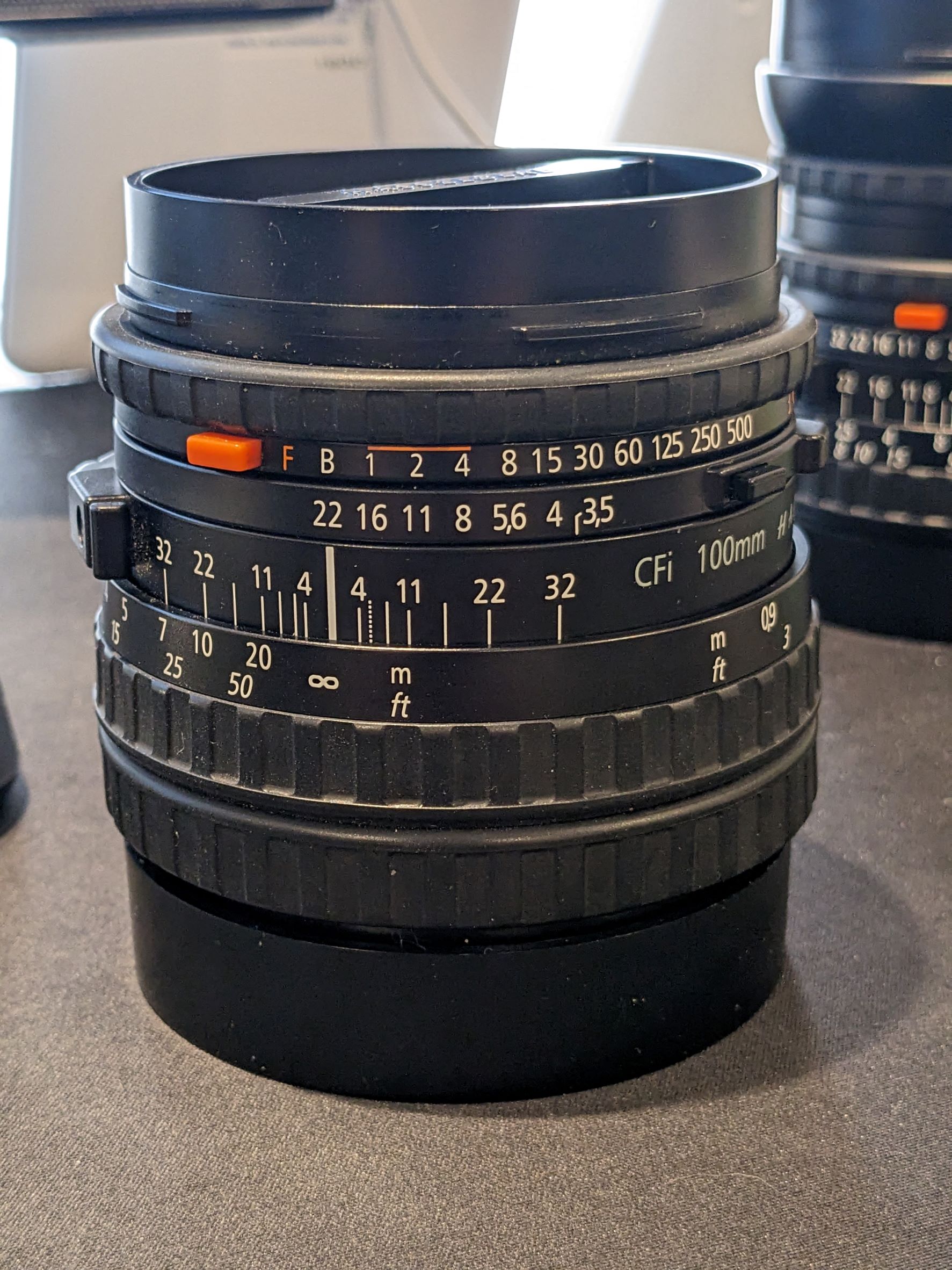

I recently acquired a Hasselblad 100mm 3.5 CFi lens. When examining it I notices a peculiarity. The minimum aperture f-stop value is f/22, however, the DOF scale has marking for f/32. I thought this was odd so I went and took a look online. Pictures I found of the lens online only has DOF marking that go up to f/22. Additionally there are some differences in how the DOF scale is marked such as the number '8' missing from my lens and only being marked by a line.
Everything else about the lens seems normal and the front of the lens is also correctly marked for being a 100mm f/3.5 lens. I have attached an image of my lens. Anyone have any idea why mine is like this? The DOF scale looks inaccurate when compared to images of the lens online. When the lens is set to the infinity position (like the attached image), the 'm' marking is at the f/11 mark. However, images online show the 'm' marking at the f/8 mark.
Edit: After comparing this lens against images of other CFi lenses, it looks like the DOF scale matches the 150mm lens. Could there have been a mix up?

Maybe there was a factory repair at one point, and that's the only replacement part they had on hand, from the 150mm?

I ordered this from KEH, I'll try to get in contact with them about this. I have not used the lens yet so I can't comment on if the lens optics are in proper order. Looking through the lens and looking at it closely I cannot find any other faults with it.

Amazing coincidence. I just ordered a 100 CFi from Camera West. It will arrive tomorrow. Their photograph shows the same DOF scale:
Oops, not correct. The one I ordered shows a DOF scale to ƒ/22. The lens only stops down to ƒ/22, not 32. Another Hasselblad puzzle.

This doesn't look like a reused part, because the 100mm model markings are on the same ring as the DOF range marks... And the entire DOF range seems to be more compressed vs what's on mine. I wonder that perhaps at some point they've decided to re-calculate the DOF scale using a tighter circle of confusion, and left f/32 by mistake? Also, @Kodachromeguy your link shows the typical DOF scale ending with f/22.
I would agree that this doesn't look like a reused part. The letter where "100mm" is printed looks factory. I took a look at the hasselblad service manual and while the part number for this DOF ring for 100mm vs the 150mm is different, that may just be to account for the different lettering. The part itself looks to be inter compatible. I would think that this could be a factory error, but hard to say.
I don't think hassleblad would have adjusted the DOF scale for a tighter circle of confusion and leave the 32 markings on the lens. I also cannot find any evidence of that in part manuals.
Edit: I seem to recall that Hasselblad hand assembles their products. Could be pretty easy to put a part in the wrong bin during assembly.

Maybe they had already made aperture and DOF scales going to 32, but decided not to let the lens stop down more than 22, maybe because of some mechanical reason, and made new aperture scales but kept the DOF scales to save money. So perhaps this is the rare first batch. 😉
I thought that too at first, but the CFi lenses are much newer than the C and CF lenses that predate it. The 100mm optical formula hasn't changed since its conception in the C series and the earlier lenses only stop down to f22 with matching DOF scales. Additionally I cannot find any record of a change in part number for the 100mm lens CFi DOF scale.
Yes, this is odd. On the lens in the photograph that the OP posted, ∞ to 10m is adjacent to the ƒ/22 mark on the DOF scale. But on the lens in the Camera West advertisement, ∞ to 10m lies helf way between ƒ/11 and ƒ/16. My lens will arrive today, and I will take a roll of Panatomic-X to test it.
Here is a CF version of the lens:
https://www.ebay.com/itm/144828603998
On this unit, the 10m mark is again located half way between ƒ/11 and ƒ/16.
The position of the 10m mark is actually between the 22 and the 16 mark, just the angle of the photo makes it look like its on 22. The focus scale can be used past the f8 marks as long as you make a mental note that they are about a stop off (f11=f8, f16=f11, f32=f22, etc). I just ran a roll of Acros through the camera and will develop it tonight to validate sharpness and functionality to ensure nothing else is wrong.

I have the 100mm CFi, and the DoF markings on mine stop at f22. Furthermore the aperture markings for the DoF scale are different, with the lines for f4, f8, f11, f16 and f22 so noted. Finally, the spacing of the DoF marks are different: on mine when the aperture is set to f22, the f22 DoF mark lines up close to f4 on the aperture ring; on yours it is at the half stop between f8 and f5.6.
The markings on mine look the same as the one in this picture:
Yours seems to have the DoF markings for the 150mm, despite the printing saying 100mm. Very odd.

I would contact Zeiss about this and see what they have to say. I did some googling, and the scale looks indeed like the one for the 150mm.
