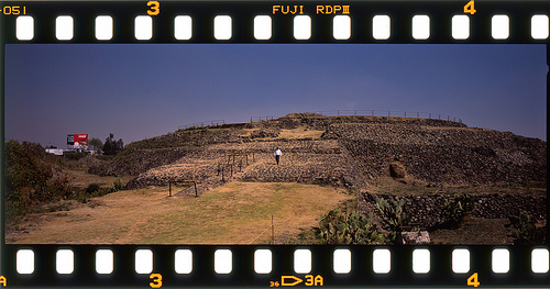

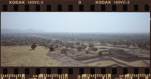

Not sure on an enlarger since I don't print stuff, but there's a bit of vignetting
47045-hasselblad-xpan-45mm-vignetting-6697928461_8dd497d738.jpg.att
47046-hasselblad-xpan-45mm-vignetting-6544846097_ced2ce640f.jpg.att
Mexico? Sure reminds me of the pyramids outside Mexico City. I can't remember the exact names, but the Pyramid of the Sun, Moon, etc... And the museum showing the obsidian knives used for sacrificial offerings(human offerings :tongue:)
Araakii
Feb 2, 2012
107
Yep! Magical place. I will go back next month (not Mexico City though).
