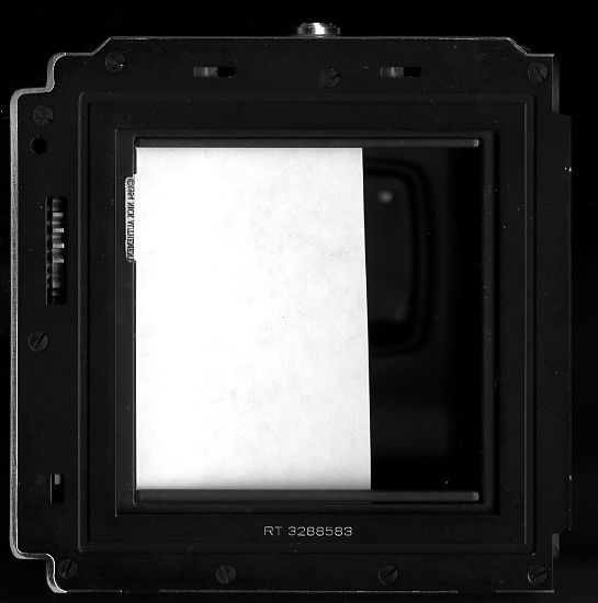

Here's a method of identifying a back that's a little heavier handed than the ones bought up so far.
I bought some used equipment about 10 years ago and this back came along for the ride. I sent it back but am glad i made this scan.
A dremel, a piece of acetate, and some tape, and you can have one yourself:
