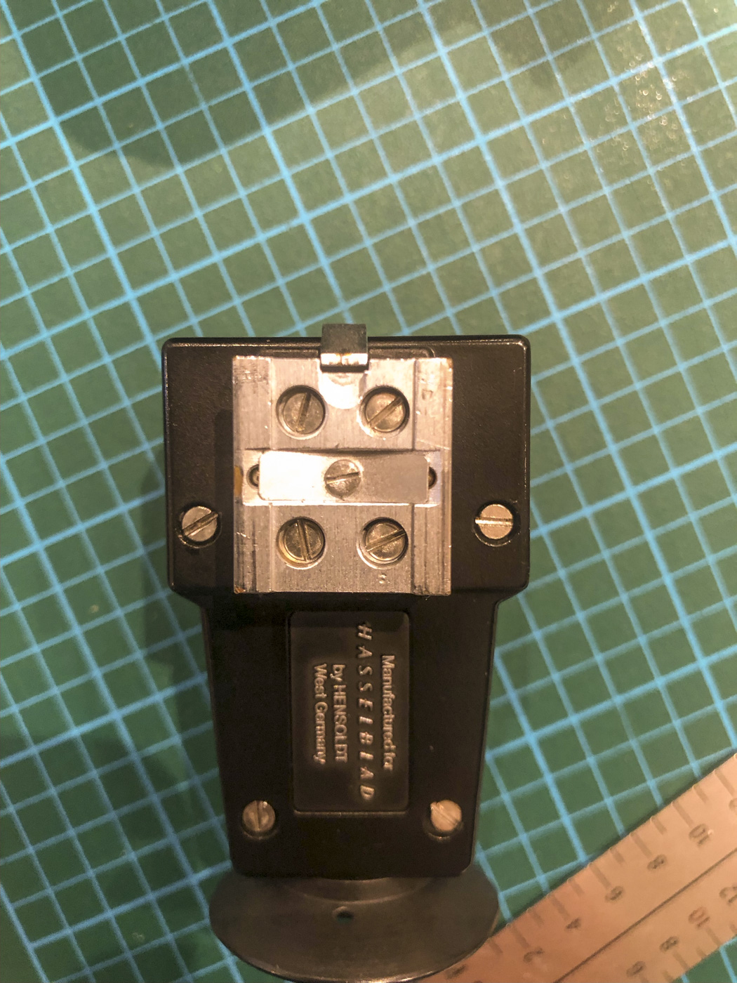

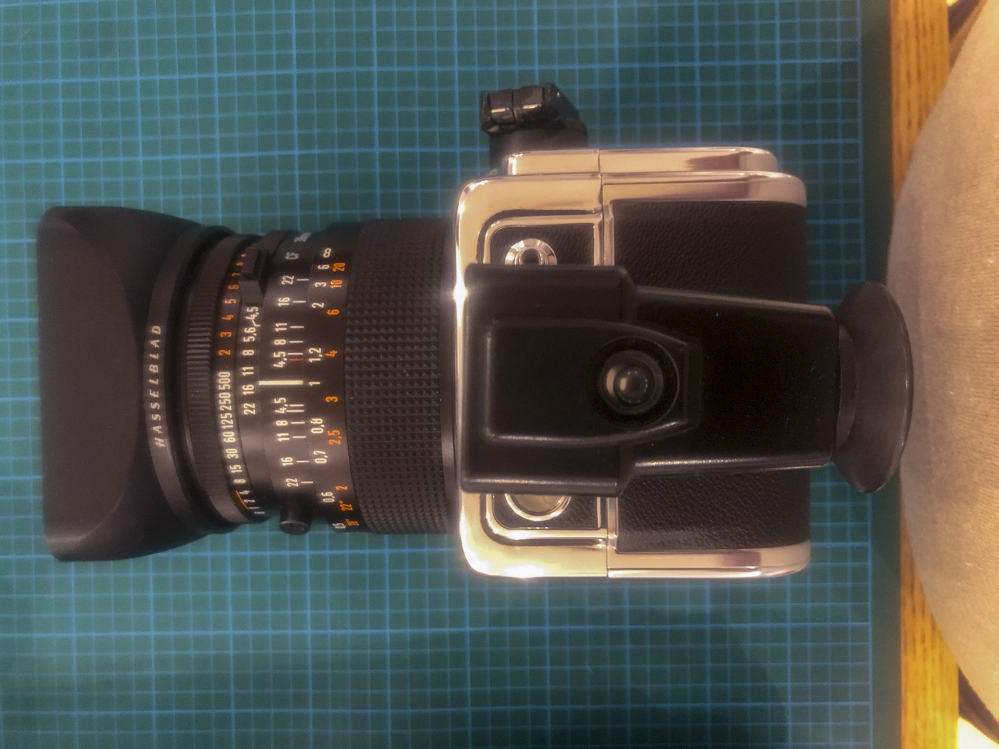

My SWC has a crooked viewfinder. Not by much but enough to bug me every time I pick it up! I'm wondering if this is an easy fix or I should have it looked at by an expert? It seems easy enough to remove the screws that appear to hold the cold shoe in place from above...While I'm at it, I'm considering removing the black spacer between the cold shoe and the body. This to accommodate the increased height of the viewfinder with a flash bracket. Comments from those that have tried either or both would be welcome....I attached pictures...Thanks.

How you removed the viewfinder and remounted it so see if that corrects the problem?

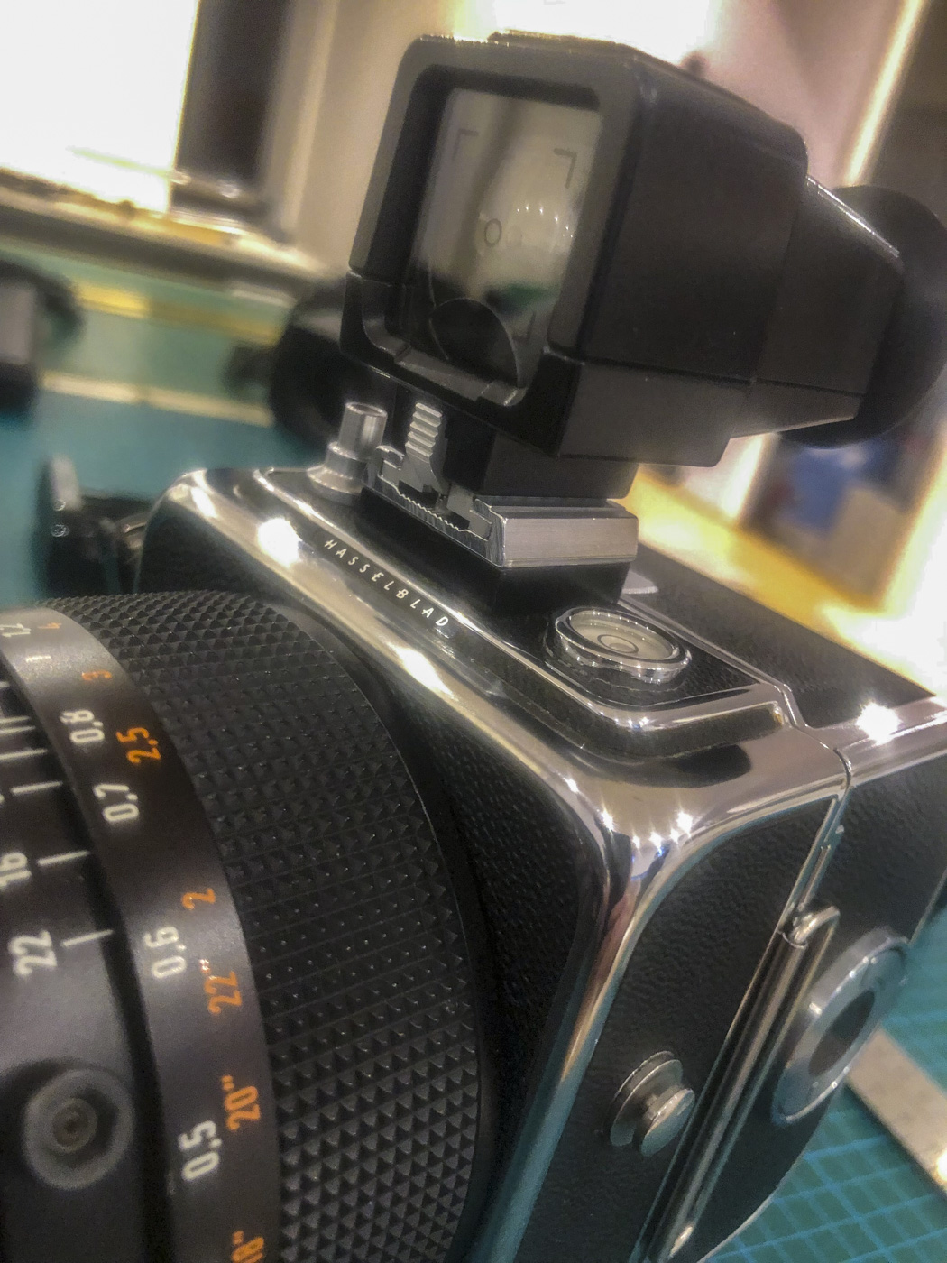

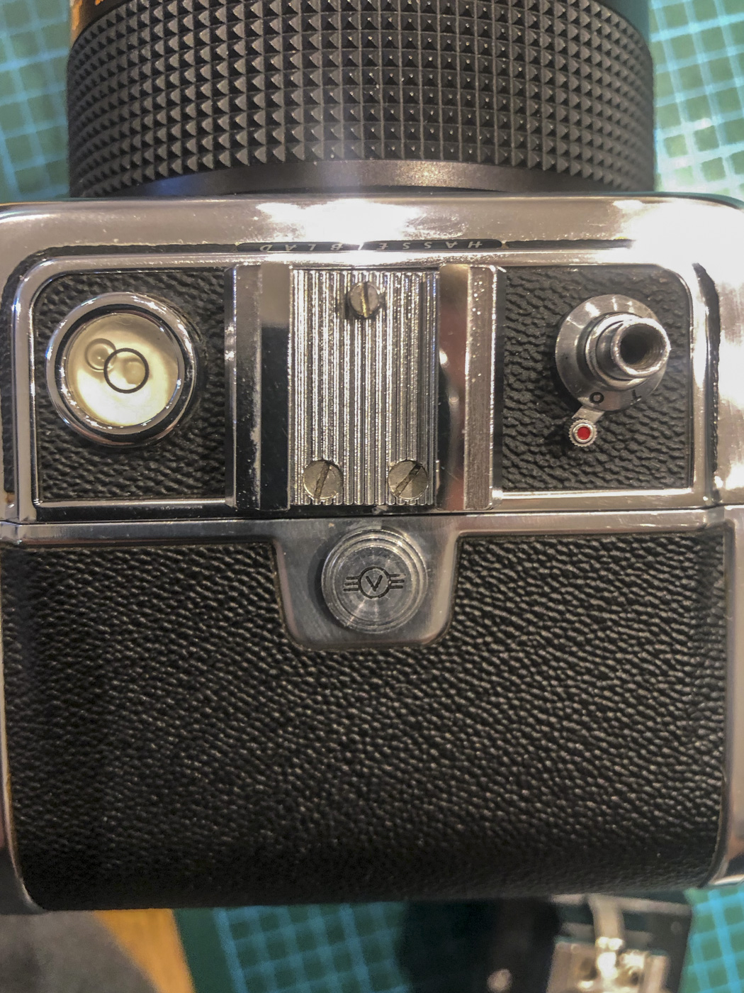

Yes, and it does not correct the issue. There appears to be a small twist in the cold shoe of the viewfinder, but a larger twist in the cold shoe adapter of the body. I attached more pictures...

Are the holes under the cold shoe drilled properly? If they are ok then you could try to get a different cold shoe.

Thanks, I'm not sure what you mean by drilled properly? Do you think it's a defect in the cold shoe? I'm wondering if the cold shoe could be straightened by loosening and readjusting...

Yes the holes appear to be lined up. I'll take your advice and bring it in for service. Can you confirm that the black spacer between cold shoe and body, and between tripod mount and body, are there to accommodate the polaroid back and serve no other functional purpose? If yes, I'll assume they could be safely removed...

That's really weird. If everything is lined up, I hope you are not dealing with a twisted metal viewfinder??
Experience in dealing with these cameras would be a must. IMHO
