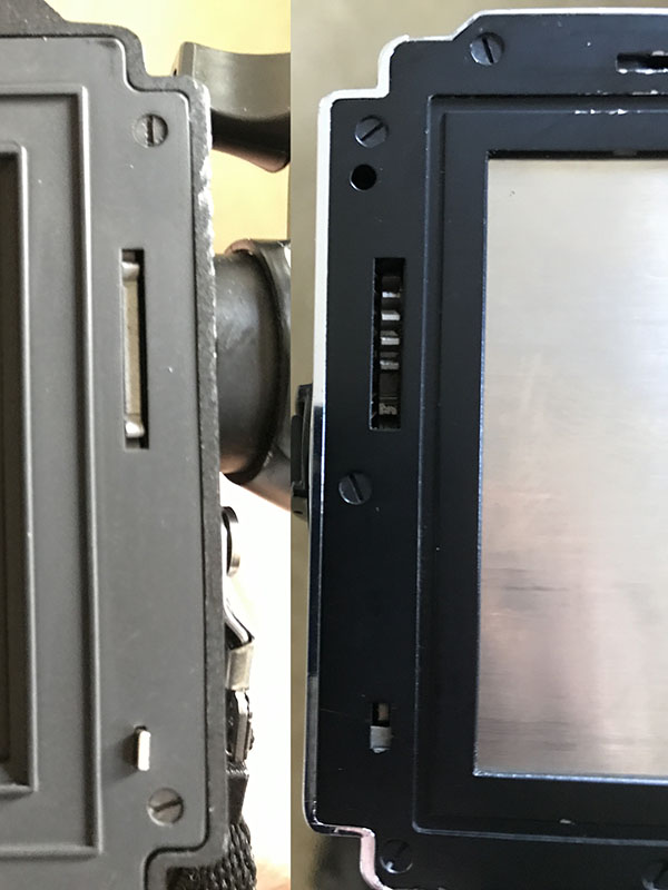

I have a new to me 500SWC. I bought it from a reputable seller, so it has a warranty, but today is Friday and I won't be able to do anything about it until Monday. That's a whole weekend going to waste! On the off chance that the issue is something due to my inexperience with Hasselblad cameras or a simple fix, I am posting here.
The shutter/film advance lever won't budge after I trip the shutter. The back shows a white dot, but the body has a red one (albeit, the dot does not fill the entire window). If I replace the dark slide and remove the back, I can wind the shutter, fire it and get a white dot. After replacing the back and removing the dark slide, the film advance/shutter lever works as expected, winding and advancing the film.
There is a little arm on the body that engages with the back that I suspect may be the culprit, but I really don't know enough about the camera. Hoping someone here does.

If I am remembering correctly, the gear in the back that engages with the body is stopped from over-travel by the 'nylon stop' in the back. When this is worn, the gear will travel too far and cause a jam. The solution is to have the back serviced the nylon stop replaced.

The gear looks like it is in the right position to me, from what I have read.
That is my recollection too.
Now that you cleared the problem take another photograph to determine if the camera works or not. A CLA would take care of problem.
