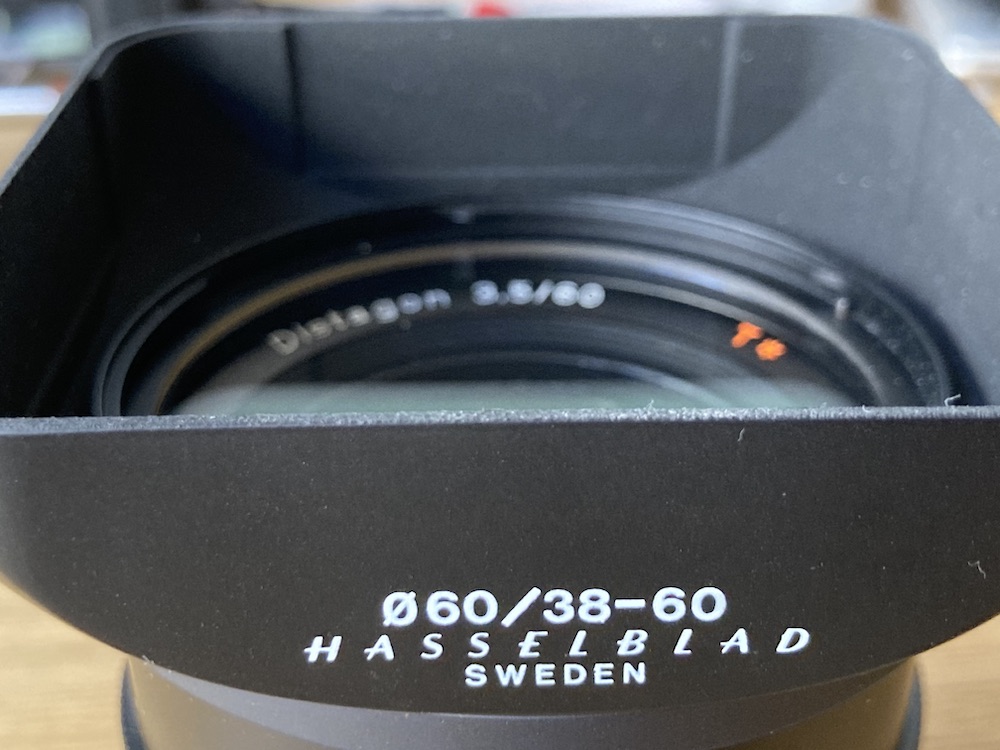

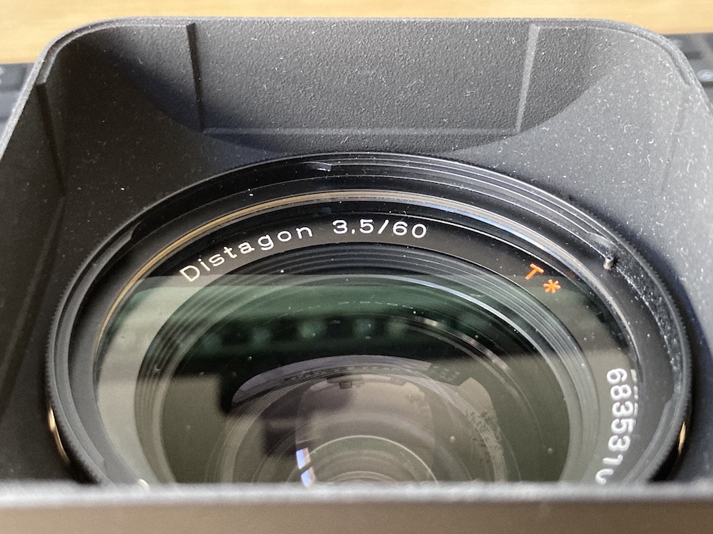

The SWC CF hood is the same as that of the 60mm CF lens. Here a few pics of how the OEM hood looks like with a B60 filter.
I have a hard time imagining how a 67mm filter would fit in there. (This is a very scientific statement, I know :D )
The inside dimension of the hood is 75mm, measured at the "top edge" (i.e. not the lens side) of the hood. So theoretically, a 67mm filter could fit in there, but you might need some spacer ring. I guess this would create a lot of vignetting with such a wide angle lens as the SWC.
I think there are only 2 options:
1. forget about using a hood,
2. use a B60 filter.
