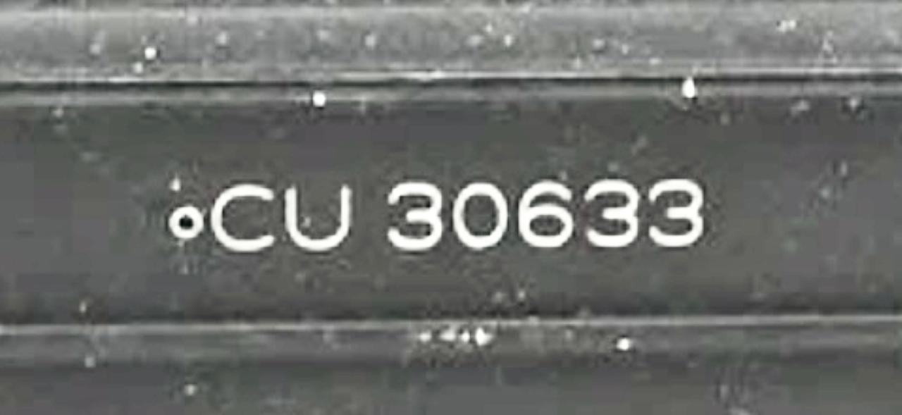

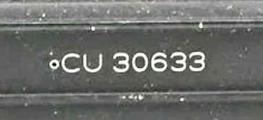

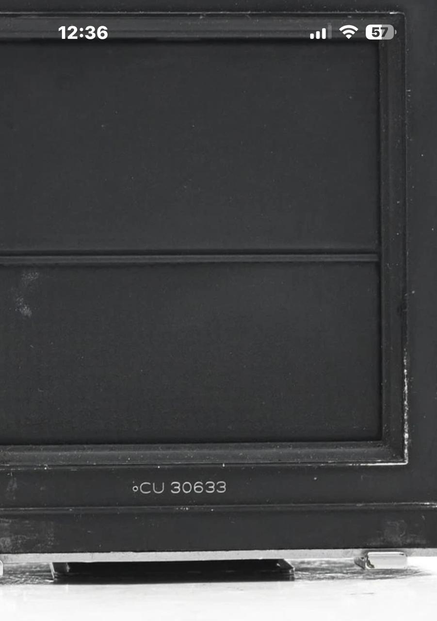

Hello and thanks everybody,
Found this thread on google search: "hasselblad camera three 3 letters serial number"
Wondering what info in the attached serial number plus its(500C) made in 1957 ?
A dot or small circle at the start of the serial number?
Thanks.

Sirius Glass
Jan 18, 2007
50,869
Southern California
Go to Hasselblad Historic [hasselbladhistorical.eu/] and put in CU from CU 30633 to see that your camera was built in 1957.
See [hasselbladhistorical.eu/HT/HTDating.aspx] to see how the two letter system works.

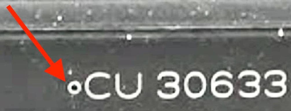

Thanks sirius and aoresteen, great posts.
I mean the small circle before the serial number, see⬇️photo please.
Thanks.
