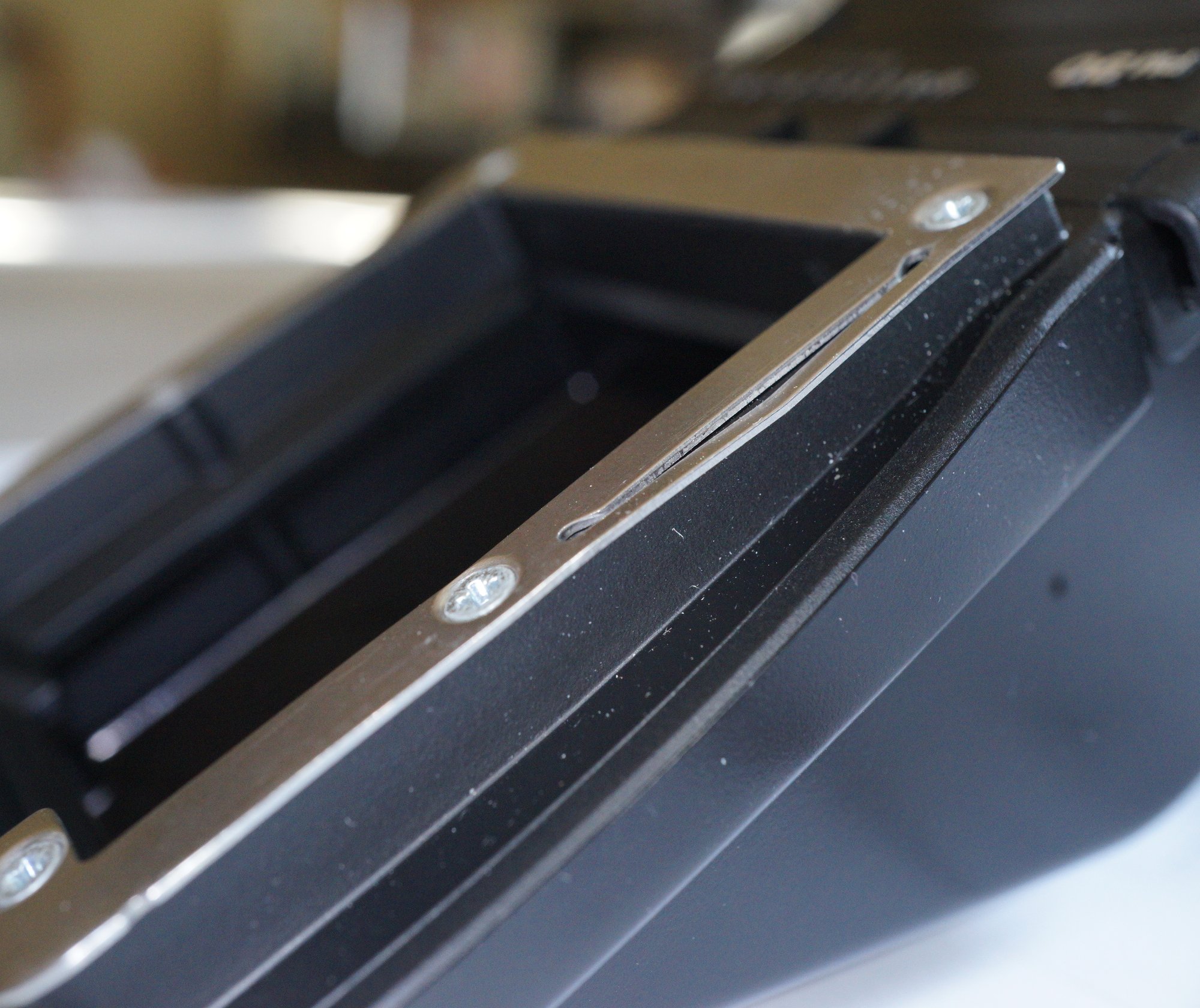

My PME51 has the serial # on the base plate, but as I said, a factory replacement would not have a serial #.
My PM90 has a thinner base plate (than the 51), but that base plate has a cut-out and a crimp, which acts as a spring to hold the prism in place, once inserted, it is snug and stable.
You probably just need to give that spring a bend.
My mirror looks just like yours from above, but looks nice an even from below.
