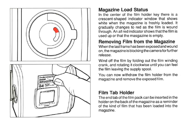

Does the Hasselblad back count exposures without film loaded?
I have a back that I haven't used in some time and I can't remember if it is loaded with film. The counter shows a number and counts up when I make an exposure, but how do I know if film is loaded? Sorry for the senior moment question!

You have film in the magazine. Look on the side and see if the red film indicator shows how much film has been used.

The counter will count, but the film usage "thermometer" will not.

Thanks Sirious and Brian. I have film! :smile:
