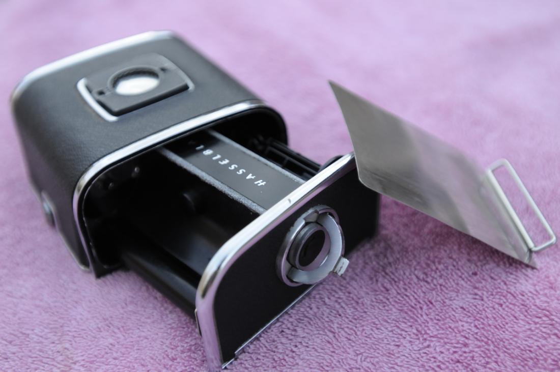

Here is an example of what he is offering for $1450. Even though i have no experience with Hasselblad i feel this price is way out of line. Am i correct?

From what I could see in the pictures you posted, it looks used as opposed to not "cared for". Most Hasselblad equipment were tools, so not babied. Especially if used for weddings.
But I think he's living in the past as far as pricing unless he has records of recent CLAs for the equipment. I'm sure he's basing prices on what he paid, not the current market.
220 backs generally go very cheap, given the relatively thin selection of 220 film now (I know some use 120 film in 220 backs). From what I've seen as lenses go, within any series, the 80 is cheapest (not surprisingly), followed by the 150, then the 50, then others.
Note that there are C backs and A backs. The C backs have a little door in the back to align the first frame, then wind normally after that. They are older and cheaper. I have a couple and don't mind using them at all, but make sure the spring loaded door in the back is tight. The picture you showed is an A back. Make sure the s/n on the back itself matches the s/n on the insert, or adjust the price downward. Backs need the lightseals replaced after a while; a relatively simple and inexpensive diy project.
Also, there are 2 types of 16 backs (16 exp per 120 roll). One produces a 6x4.5 negative and is desirable, the other produces a 4x4 negative for "super slides" and therefore is an albatross (but not very common).
I have a 50, 80, and 150 for my 500C and use the 50 the most. I have no problem with the chome non-T* lenses. But I use a lens shade and most of the time use on a tripod so can shade the lens with a hat or gray card. Assume you'll want at least 2 backs. I find it much easier to use a prism finder rather than the wlf. Of course, all subject to personal preferences.
You may already know this, but the shutter in the lens is cocked via a linkage from the body. Make sure there is not excessive wear on the body side or the lens side (looks like a flat head screw on the lens). Sometimes they get out of sync if the body is fired while off the lens. Here's info on that: http://photoweb.net/pw_tech/hassy_unjam.html
