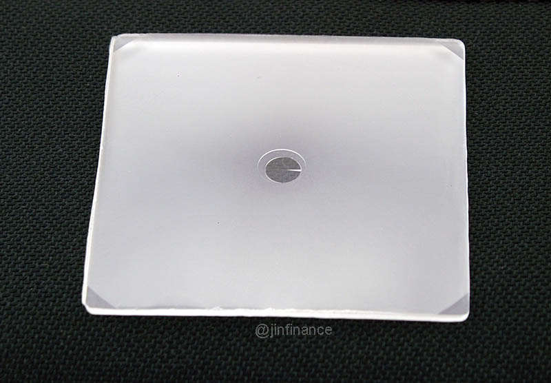

Two bits of information, please, before I possibly buy one myself (for a Mamiya C220.)
  1. Is the item mentioned by macfred and approved by RalphLambrecht the same as sold by seller jinfinance
    I know the price is different from the mentioned 39€, but sometimes several Chinese sellers propose items from the same original source... Please have a look at the picture.
  2. If answer to (1) is yes, down to what aperture have you been able to use the split prism without blackout? I have, besides the 80/2.8, the 55 and 135, both f/4.5
Thank you

Thanks for the heads-up. I've been meaning to try one of these for ages. Worth giving a go for £23 including delivery.
I bought one of these this past fall- definitely a bit brighter than the stock screen yet just a hair darker compared to whatever screen came with a 500C I bought (no-name with dark cross hairs I have yet to properly identify. Beattie maybe?). Installation was a little tricky too since it doesn’t come with a frame, so I ultimately ended up using the no-name screen.
If someone wants to cover the cost of shipping I can dig it up I can send it to an apug/photrio user who is interested in trying it out.
