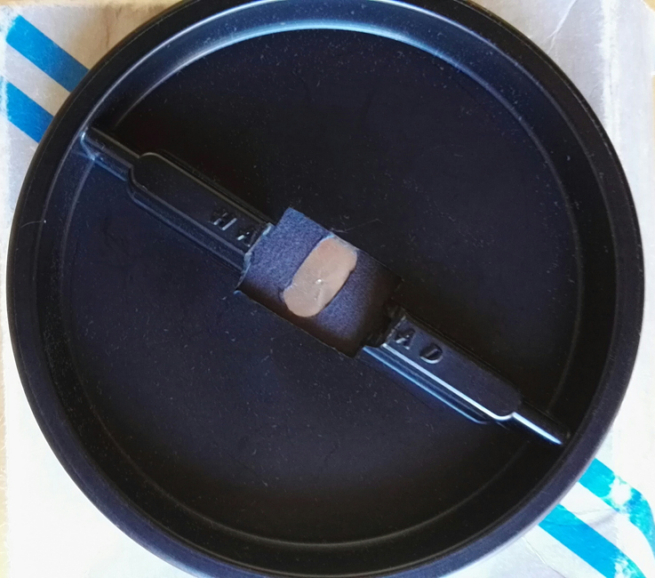

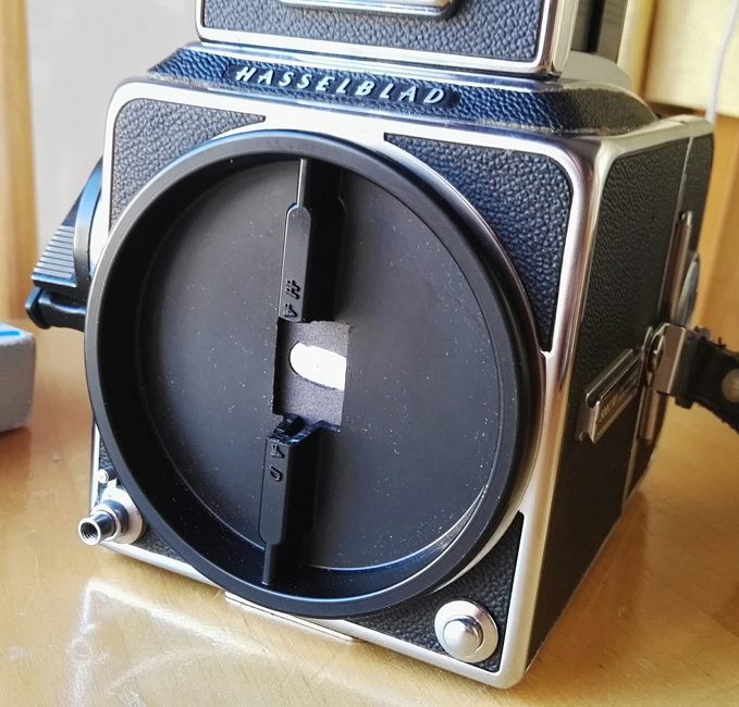

So I didn't have enough money and I could only buy the body, but couldn't wait to shoot. This is what I did

I usually use my Distagon 50 mm and I haven't spent much time in pinhole photography. There was long time ago but something I can share. I used a tripod and after I got the diaphragm of my pinhole the process was the same as photography with lens.
Yes, exposure always was more than one second.. There wasn't air to move the leafs.

I bought a pinhole body cap for my RB67 and it works great. I take the film back and pinhole dap off to look through the camera to line up the shot. Been awhile since I used it but I think after testing I expose at 4 or maybe five seconds on a sunny sixteen time of day and double the time for every second under that.
