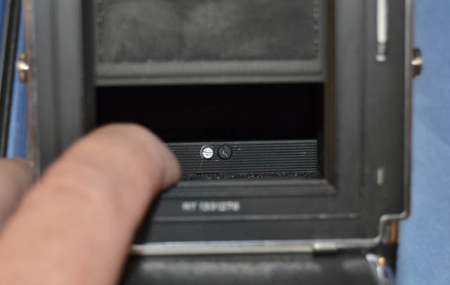

Possible problem
I have a hunch.
First make sure that the shutter lock lever on the front of the body where the shutter release is. Make sure that little lever for shutter lock is not set the wrong way.
Next, the prefire condition, where the body and the back are not in sync with each other. This happens by sometimes by accident, it's happened to me.
1. Put the dark slide in and remove the back from the body.
2. Try and cock the shutter with the winding knob/crank on the body. Is anything happening? If it's stuck, you have the body and the shutter out of sync with each other.
3. To fix this you may need to manually cock the shutter with a small flat blade jeweler screwdriver. See my pic below for where the screw is, after you push gently on the lower baffle of the light trap on the back of the camera body.
4. Carefully pushing forward the lower baffle. Look at the floor of the mirror box. You should see a screw like my photo.
5. Examine the screw position. If the screw is horizontal like shown, then it's cocked. If its slot is up and down, you need to make it look like the photo. It takes 3/4ths of a clockwise turn with the screwdriver until the screw clicks which will then manually cock the shutter.
Note, this is a shot of the rear of my ELX body which may look different than your 500C/M.
Let us know what you find out.

Bingo, got it to fire with the back off, so whatever I did, I'll try not to do it again. Bill Barber
