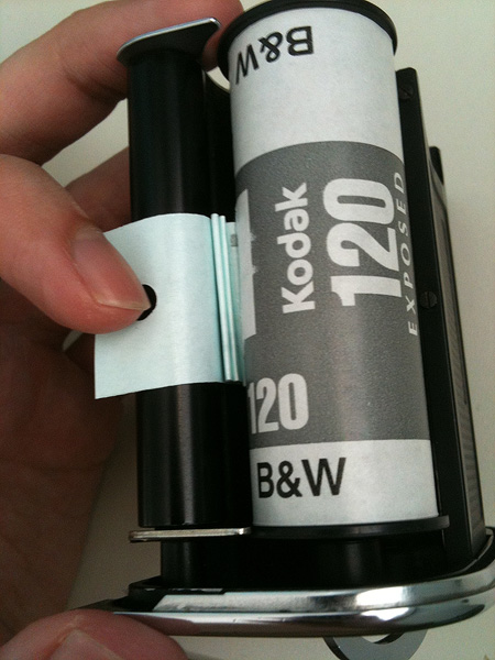

I just bought a used magazine back for my Hasselblad and I think it has a problem when it comes to winding up the finished film into the take-up spool. After the 12th frame, normally I just wind up the remaining film and paper into the spool but for this one, significant effort is required to do the winding at 1 point, and the result is that the tail of the film which has that bit you wrap around the completed film is scrunched up like an accordion has totally come off the film paper backing.
Is there any fix for this? I suspect that piece of metal which holds the film tightly wound is catching on the tail end.

I've had this happen (increased effort at the very tail end of the roll), but never paid much attention to it.
You could just open the back when you get to that increased effort point and unthread the paper from wherever it is at that point. An inch or so of paper off the spool until you secure it won't matter.

Ah ok that makes sense. But I am wondering if this means I have a faulty back or it was because of the film.
