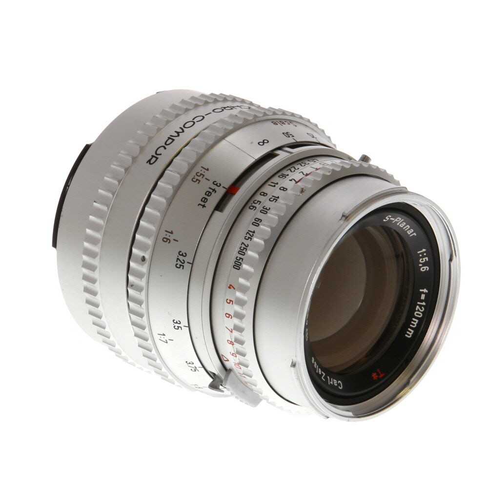

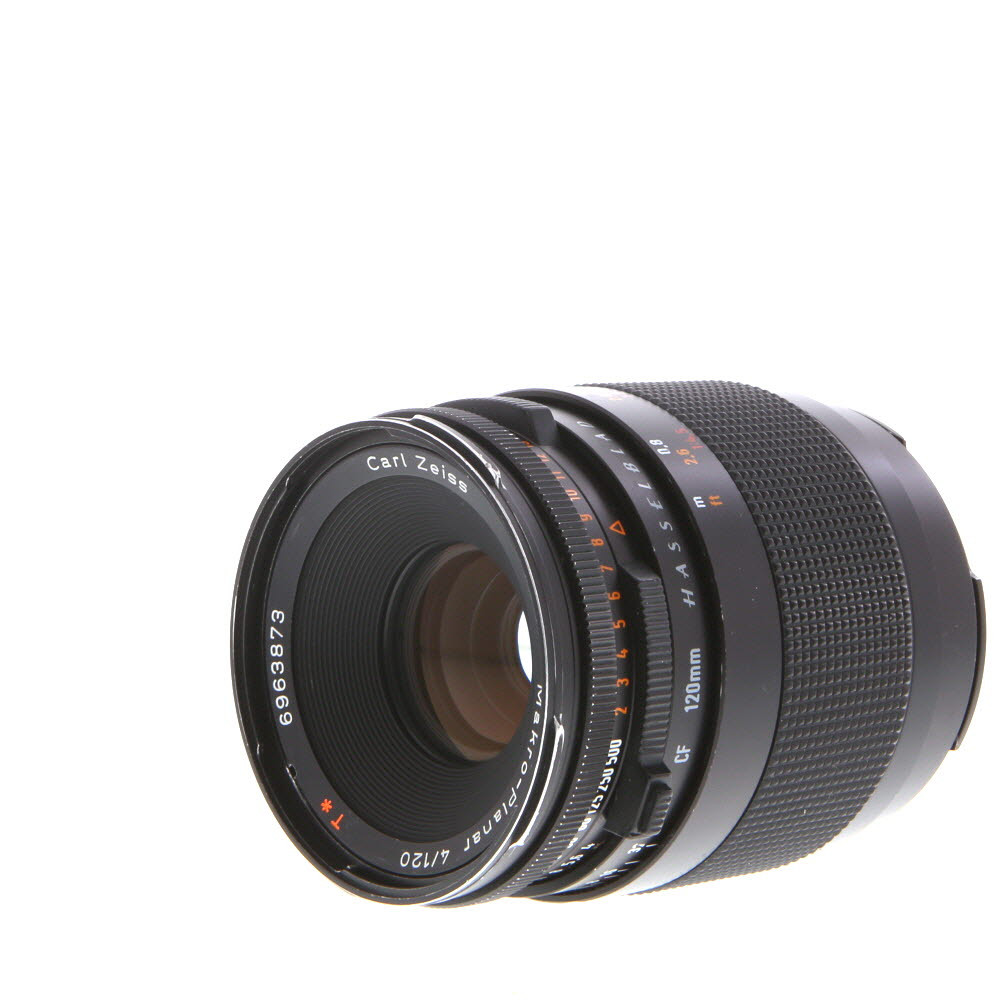

What is the practical difference between these two macro lenses? I have all of the black series lenses in 50mm, 80mm, and 150mm. I'd like to add the 120mm and am wondering what, if any real difference there is between these two. Older one goes for $300 and the newer is almost $700. Thanks for your input.

No practical difference that I could ever discern.
The price diff is refective of the diff in age and likelihood of need for an overhaul before being reliable for use.
They have different shutters and a few other nonpractical differences.

Well, not much difference apart from the extra stop and the obvious C vs CF difference, of which you are surely aware (if not, please see here https://www.photrio.com/forum/threads/hasselblad-c-t-vs-cf-or-cfi.134879/ - there is also a lot more resource on various places on the internet about this).
You can compare the specs here:
http://www.hasselbladhistorical.eu/pdf/lds/C120.pdf
http://www.hasselbladhistorical.eu/pdf/lds/CF120.pdf
The CF can focus somewhat closer without extension rings, 0.8m vs 0.95m... does that make a difference in practical use??
EDIT: most C lenses have B50 filters. The CF has a B60. So if you have other CF lenses, it might be good to go for the CF and use only 1 size filters.

The two lenses are not of the same optical design. The 120 S-Planar is one stop slower, and will not focus as closely. It also flares more from what I have read (older coatings).
