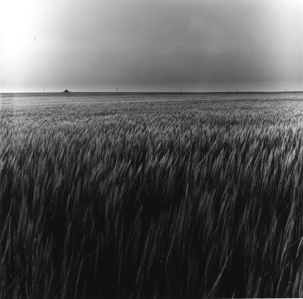

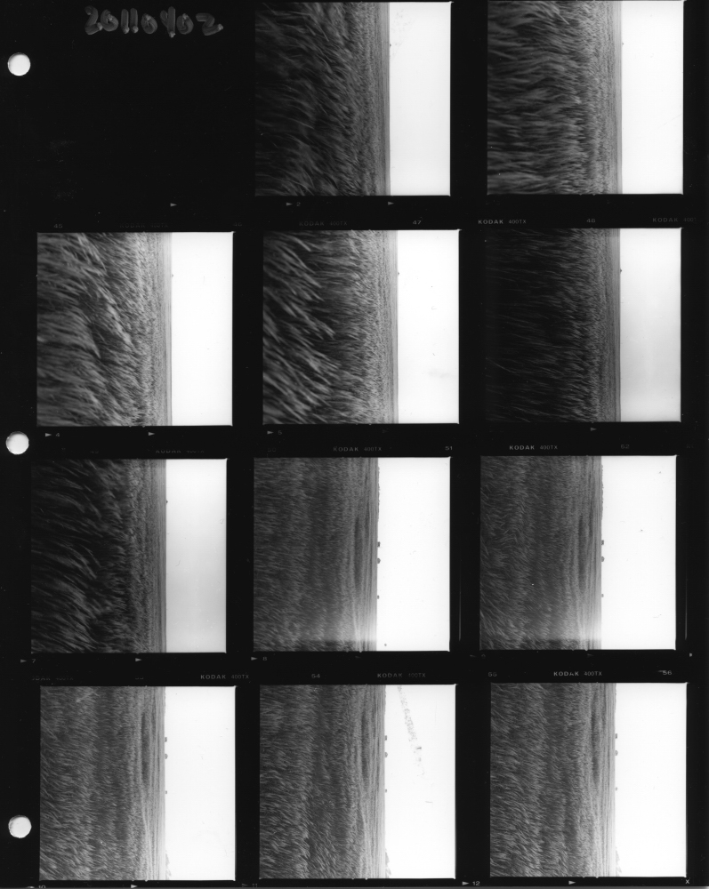

Will you folks take a look at these scans of a contact sheet and a proof print off the same roll and tell me what you think these light areas are?
This is from a Hasselblad A12 back. You'll see very obvious light areas on frames 8 and 9 of the contact sheet. The print is from frame 6 and you'll see a much fainter light pattern with a definite straight-edge cutoff on the opposite side of the frame as the others!
Weird. I can't figure it. Seems like a light leak would be consistent on all frames. Seems like a development problem would also be more consistent, frame to frame, and would not have the straight edge these light areas have.
Thanks for any help.

looking at your contact sheet it appears to be the space between your dark slide fits in on your back... if you unscrew all the screws on the front side of your back you can inspect the light trap that covered with felt... sometimes the felt may be worn out...
check here for fixing instructions
http://www.hasselbladhistorical.eu/HT/HTSeal.aspx
also if you keep your dark slide half in the slot than it can rupture the light seal too...always take the darkslide out...
the ghetto fix is to put a piece of tape over the darkslide slot when the darkslide is outside the camera

Load your camera with sensitive film (Tri-x), put it in the full sun with the dark slide slot oriented towards the sun, shoot a frame after some time of exposure to the sun, do this 6x, then do the same with a piece of opaque tape over the slot.
Your problem looks like a light leak from the slot but it's nice to be sure before doing a replacement of the seals.

light leak for sure--happens to the ones with FOAM in them for a light seal by the dark slide--I had the same thing and send it out for service---knowing better now, I could have got foam from the craft store and used that---or better yet--use felt like the old ones---

Awesome, guys, thanks for the fix! I may call KEH and see if they'll exchange the thing, but looks fairly easy to fix.
Seems weird to me that every frame would not have the same leak pattern though

The backs can also leak from the gear opening, very common. Take a look at David Odess' site and/or his posts here for info. I had a back (and body) overhauled by him and it's perfect. Well worth the money...

Replace the light seals.
