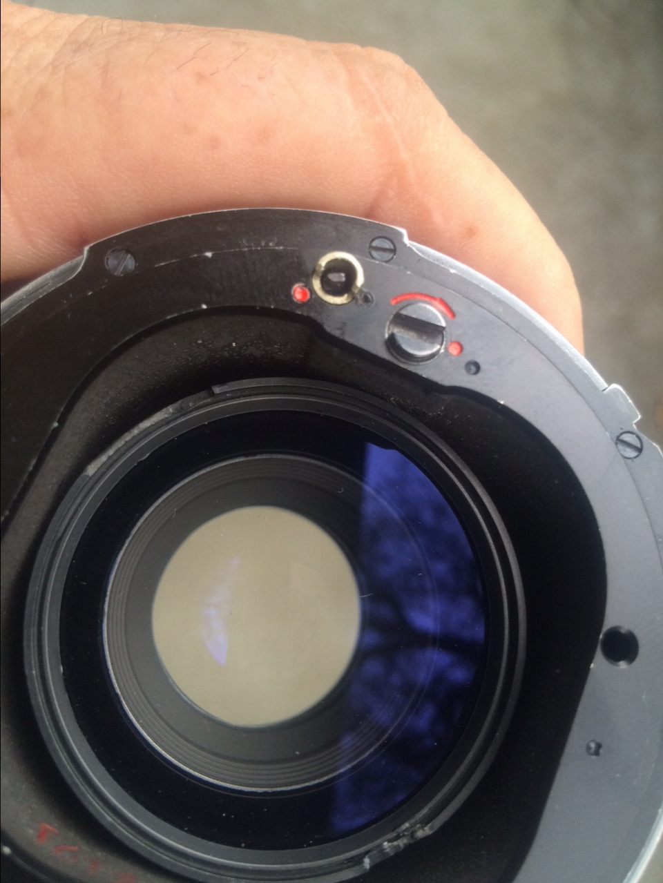

One of my Hasselblad C lenses has decided to become uncooperative and will not mount. I have made sure that the lens is properly cocked, as is the body, but despite being able to mount other lenses, my 150mm is being obstinate. Under magnification I cannot discern any difference between the various lenses in their cocked state. Is is possible that the half tube that surrounds the shutter trigger has rotated slightly and is now an obstacle? If so, is this something that someone who is pretty handy with tools can adjust? I have a series of test shoots coming up for a local modeling agency and the 150mm is a staple for these kinds of events and I would definitely like to have it in my arsenal. I recognize that a CLA would be the obvious answer, but short of that can anyone offer any insights or suggestions?

I would guess that your shutter (lens) isn't really cocked and locked. Maybe if you post a pic we can help you discern better.
I'm pretty sure that it cocks properly. I can trigger it and recock without any difficult as long as it's not mounted.

That looks correct, another possibility might be that one of the screws in the lens mount may have backed out.
Is the key in the body aligned with its red dot?
There is no red dot on the body, except for the one that indicates lens orientation. The key aligns with two pins. 4 other lenses mount without difficulty, so I think it is down to the lens rather than the body

Even the shield around the release lever looks correct. Something odd is going on!

from the picture, it looks like someone has messed up that retaining ring's notches. DIYer might have moved something or screwed the mount in some way.

To my eye the drive key way is nearly lined up with the red dot, but not quite. It's a few degrees off. The red dot should be centred relative to the key way. All my lenses line up perfectly. Perhaps it's enough to make the drive key balk when you rotate the lens.

I'm pretty sure that it cocks properly. I can trigger it and recock without any difficult as long as it's not mounted. View attachment 153121
sorry, but this looks just fine to me.all my lenses mount without wffort and look identical to your picture.this is beyond me.
