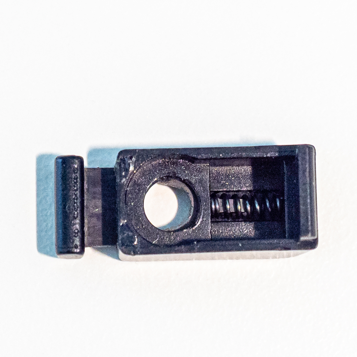

Thanks, I guess I wasn't clear. The link you gave is for the socket itself. What I need is the little plastic piece that sits on the Hasselblad lenses and surrounds the socket. It has a sliding mechanism that locks the sync cord in. Actually I have the piece but can not figure out a secure way of reattaching it to the lens. I can actually use a flash as it is, but the cord is not locked firmly into the lens and could come out.

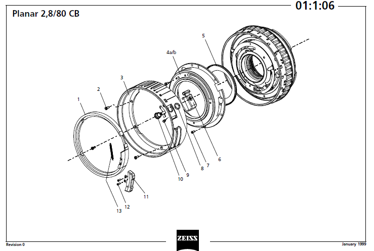

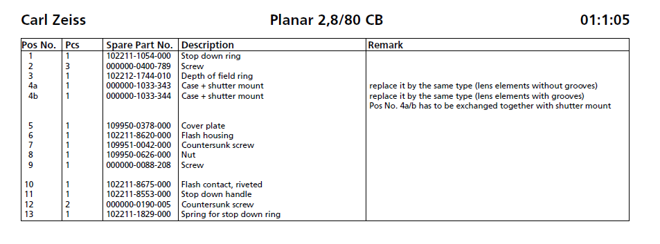

Part 6...

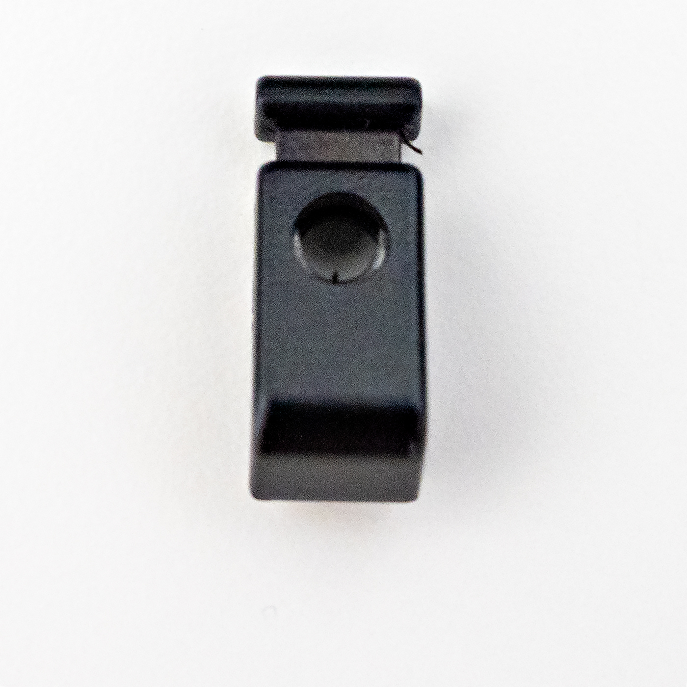

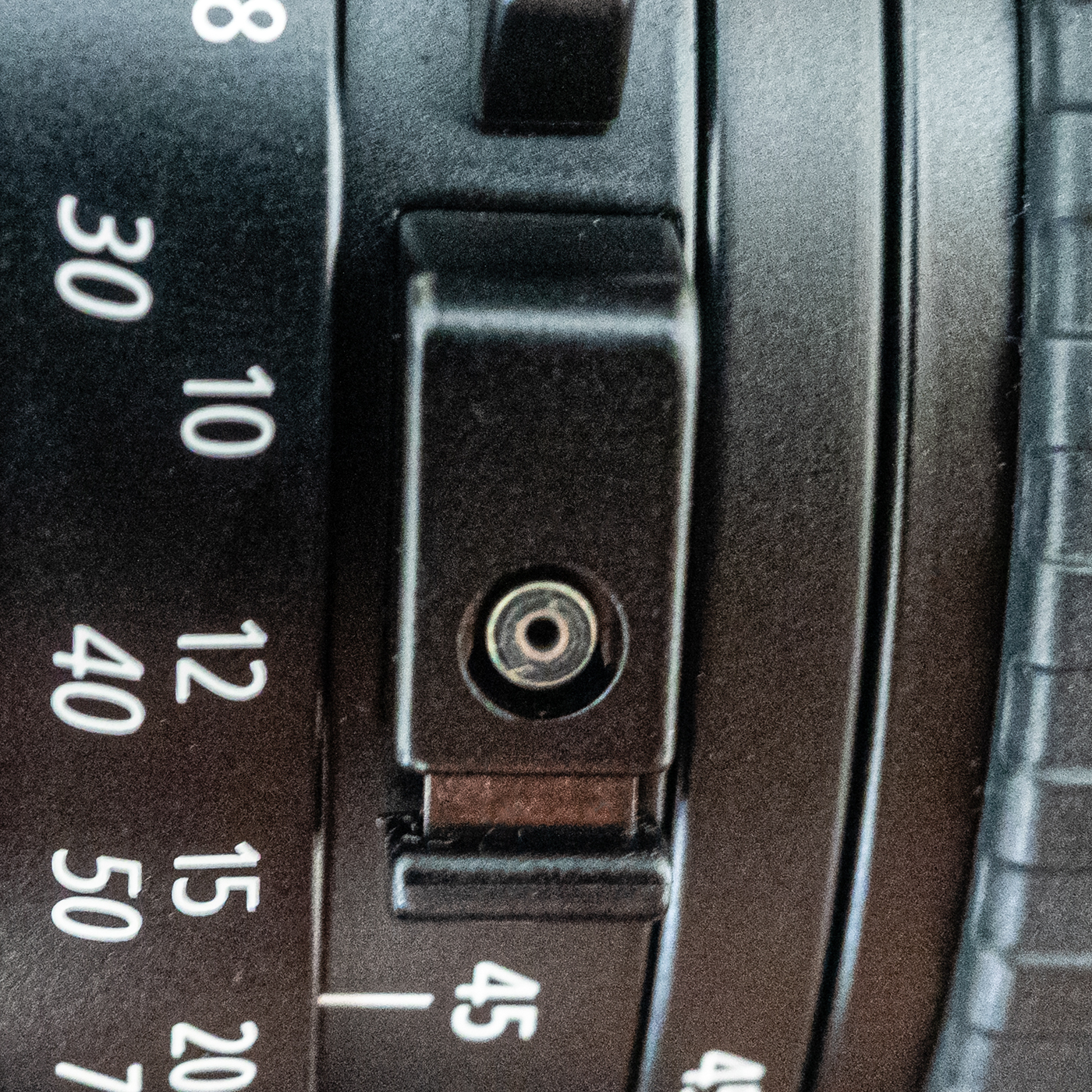

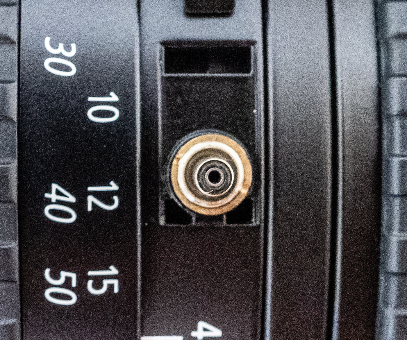

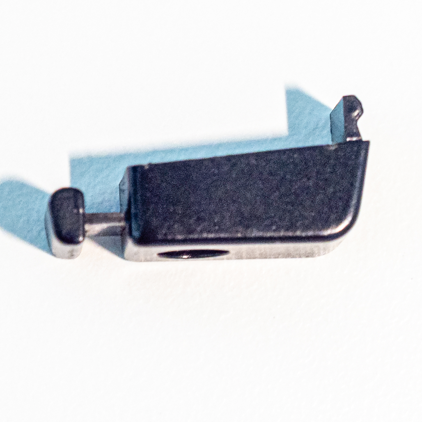

Lens with Flash Socket.jpg Lens without FlashSocket.jpg Detached Flash Socket.jpg
The first image is with the piece attached. The second is w/o the piece and the third is the piece itself.
BrianShaw (thank you) has added a diagram that shows the piece I am referring to in relation to the lens. See numbers 11 and 12. I have 11 but there is no sign of the attachment screws or even the part they would attach to. However my lenses are CFE and CFi so they may be slightly different in that regard. In any case I don't have the expertise to disassemble a lens. I was hoping there was a simpler work around like a touch of glue. At this point I think I will just protect the open socket and live with it as is.

Looking only at the diagram in the repair manual, it appears to be held by a screw, part 9. What is on the back side of the part???? I don't see a hole for a screw in the ring, part 3, though. Is that screw holding the spring mechanism together????
mitrajoon
Jan 2, 2014
119
Brian there is no hole for attachment. The two photos show the underside and side view. You can see the spring that locks the flash cable into the pc socket. I first assumed that I could just snap this piece back into place, but that doesn't work. There must have been some mechanism that held it in but I can find no reference to that, other than the diagram you showed. I have 5 lenses and this piece has broken off of 3 of them. At the end of the day the lenses work fine w/o this lock, but I would love to have my lenses restored to original condition

Yup... looks like it once snapped in place and the "snap part" near the locking lever is gone. What a shame... That seems a part that could be subjected to lots of stress (if PC is pulled without releasing the locking tension first). I had no idea it was that 'cheap" in construction. And, yes, you certainly can use it without the part but I completely understand why you'd want it.
I don't want to encourage it (I probably wouldn't)... but JB Weld is one heck of an epoxy.
Good luck.
mitrajoon
Jan 2, 2014
119
Thxs, I'll live with it for now. At some point I'll test the epoxy on a lesser used lens.

The photos by the OP show a casing around the standard female connector that inside shows a (seemingly metal) crescent part against the stem of the connector. Furthermore at the opposite side of that crescent a kind of button is protruding. To me this all looks like a spring loaded crescent locking collar, deactivated by that button.
To make this lock work a proprietary male PC-connector with a flange would be needed. Of course a standard male PC-connector could be used too, but then the locking feature would not work.
In case, based on those photos, I got it wrong, please enlight me.
