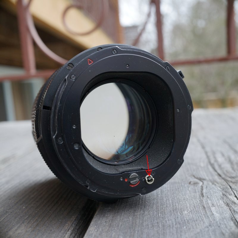

Check the small shielded release pin is moving freely. It may be stuck in the "trigger" position, stopping the cocking mechanism locking.

I did wonder about that pin, it seems to be fully raised and cannot be pushed down.
Thanks, Ben

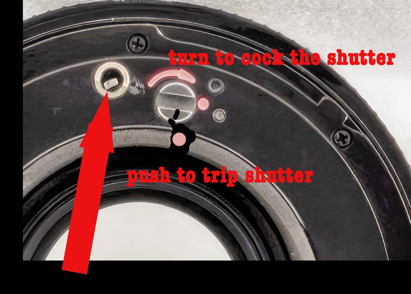

When you cock the key, at the end of the wind when it aligns with red dot (after almost a full turn) you should see the pin that is protected by the 1/2 circle pop up. If it does not pop up, then the internal latch does not hold the shutter open.
The pin at the arrow is up, if you push it down the lens will release.
If this latch is sticky or bent, then you may get what you are experiencing.

Thanks for all of the responses.
Looking at that pin again it is clearly "loose", it freely moves side to side so I assume that the internal mechanical linkage between this pin and the cocking key is disengaged.
As there are no visible screws to remove the rear plate on this CFE it's going to be a professional repair job. Next problem - finding a suitable repairer in Aus!

If that pin is loose, means the spring inside got loose or the piece is broken. Last summer one C version came in such state, any camera repairman with Hasselblad experience should be able to fix it.
The mount plate is held on by radial screws, on the side of the mount.
if the spring is broken or has come off, you should be able to cock the lens by rotating the key, and holding it at its stop while pulling the pin away from the semi-circle. Don't mount the lens like this though, as it'll mount fine, but if the spring is off, it may jam trying to remove it. (And if it jams, this will be a "bad" jam!)
If it won't latch, the latching arm is broken or bent (I've seen a few of those).
Relatively easy to fix, but the parts of the CFE lens are hard to get (but easy to fabricate).
