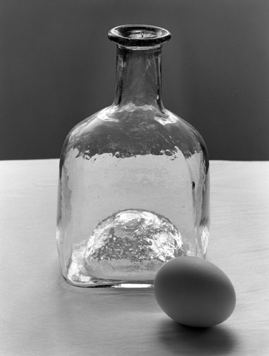

Brian, here is some still life I shot in my livingroom with the 150mm Sonnar. No extension tubes needed here but it is good to have them for flexibility. Bottle_and_egg.jpg

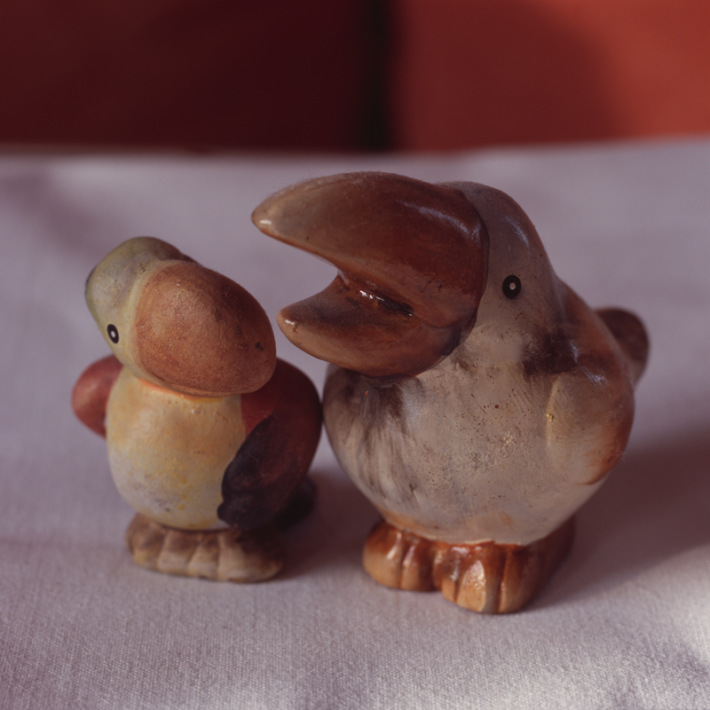

Yes, the old S-Planar 120/5,6 is just as good as the Macro Planar. MTF indicates it is even better in the close up range in fact. These can be had at bargain prices today. Just make sure the shutter works properly. This lens has very high resolution and picture quality is very even across the frame. No distortion also. Bokeh is nice too.
(These birds have a size of about an inch.)
Excellent recommendation! I just looked on KEH and found a chrome one of these for $400! This may be a nice choice.
