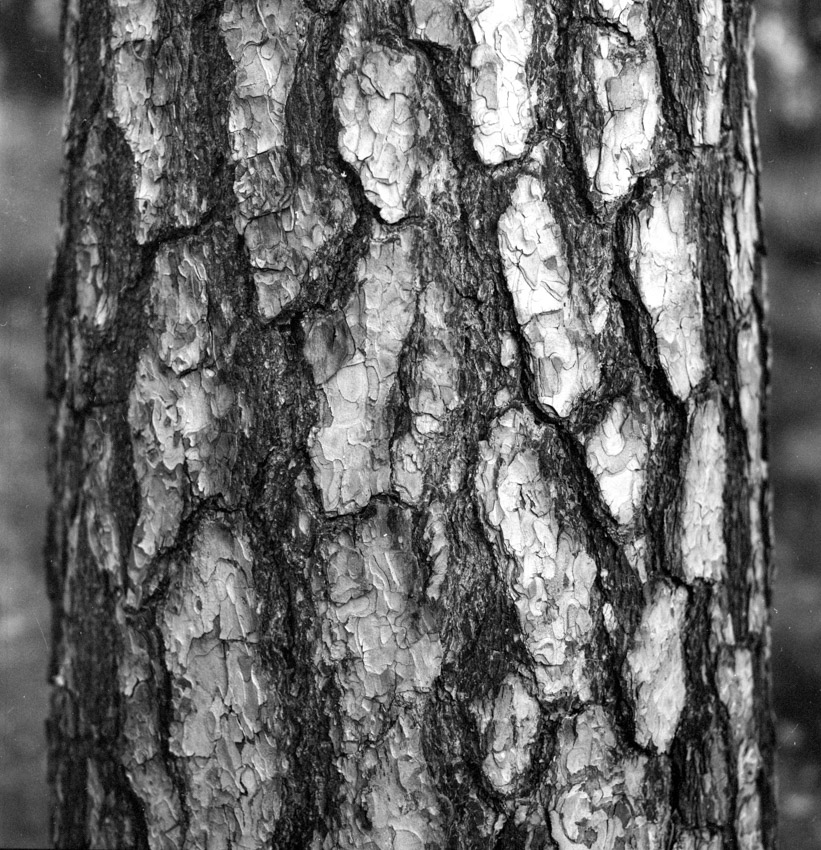

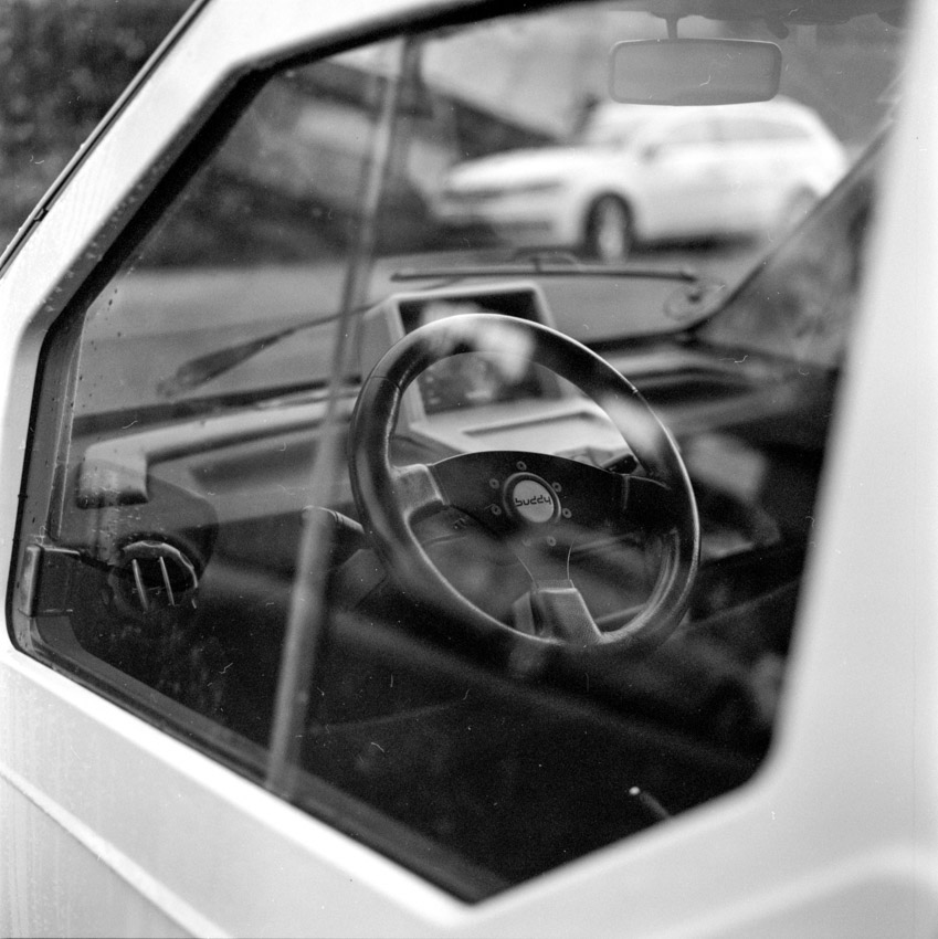

Anyway, I just scanned the test roll I shot yesterday, post butchering by my local serviceman. However unconventional his solution, the focus is at least spot on, both on infinity and on short distances at f/2.8.
