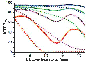

If you take a moment to study the Zeiss MTF diagrams you will see why the edges are not "sharp'.
http://www.hasselbladhistorical.eu/pdf/LDS/CF30.pdf

The MTF shows that the Sagittal 40LP/mm is 60% or above except the last 10% only(that 10% is not edges, it's well in the corners).
The Tangential 40LP/mm is below 40% in the last 25% of the frame diameter.
But hasselblad when represented it's SWC performance, they used the Sagittal line only of the 20LP/mm.
The Sagittal 20LP/mm of the F-Distagon is 80% or above all the way until the last mm in the corners. That's even better than the same line and orientation of the Biogon/SWC.
But please consider that the subject size is smaller 21% in the F-Distagon 30mm compared to the subject size of Biogon 38mm.
Centeral 60% area of the F-Distagon, is super sharp as expected.

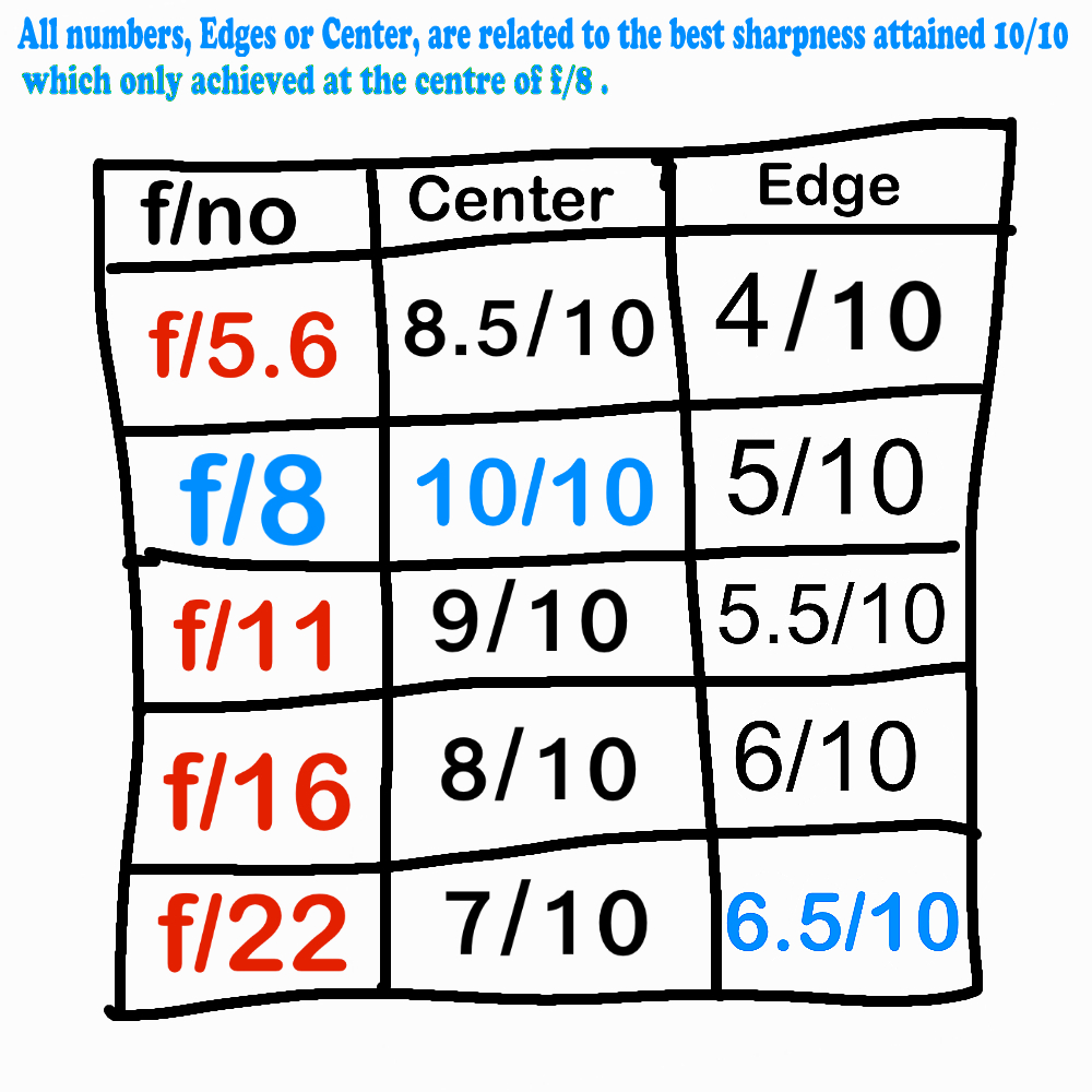

I did another two(2) sets of tests, because the first test was not super methodological and was choosing the best edge sharpness negative among other negatives by a well made 10X loupe, then printing to the same scale 10X.
Most of the second test set already developed, and can conclude based on examining under my 10X loupe.
Nine(9) films up to now!
Please continue discussion.
Thanks so much.
alentine
alentine
Nov 4, 2006
206
At what aperture are you noticing the softness, all?
Thanks so much Brian for your question.
Was not able to answer you accurately before I conducted the second set of tests.
Now, I can confidently say:
The edge(not corners) sharpness is improving with closing down.
Not good at all at f/3.5, clear unsharpness at f/8, and best sharpness was somewhere at the range of f/16~f/22.
It improves very gradually but does not at all reach the center sharpness at any f/stop.
Center sharpness on the other hand reaches its max at f/8. Start to decrease with closing down after f/8.
But, at f/11, f/11.5 and may be f/16, the center sharpness still high for a 10X enlargement.
Thanks Brian, and thanks all for studying the following table:
Absolute numbers and relative impressions do not means too much.
But, when related to a certain reference, it can give much better understanding.
All numbers in the table are estimations related directly to the best sharpness achieved by the lens(given 10/10), which was at f/8 and in the center of the negative.
Now, is this shape of performance expected from F-Distagon?
Thanks indeed.

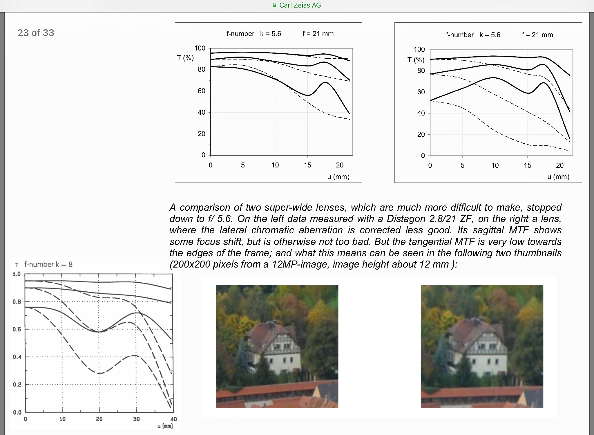

" ... It has been designed as a special lens for scientific and technical documentation and offers therefore outstanding image quality and very even illumination from corner to corner – and all this even at wide open aperture. ... "
To me, it looks that the lens I'm testing to decide for keeping it or not, is not performing as it should, unless the evenness that Zeiss is talking about is for illumination and not sharpness!
Thanks for sharing your input and experience.
As for the MTF, and specially the Tangential/Meridional lines, I've found this:

Just to add something related well to the topic of this thread. A sample MTF accompanied with text analysis of the significance of deviated tangential curve on image appearance.
To me, it’s a great resource to the thread and topic.
https://www.opticallimits.com/mtf
An example for a lens performing relatively good in contrast but showing only a limited ability to transmit very fine structures ( tangentially at 40 lp/mm)
Among discussion of other MTF curves on the same page.
The page does not comment on the field curvature in the example MTF.
The next MTF example, belongs to the text quote above.
Hope this adds to a better understanding of the topic, though I believe without a simple and clear method of visual correlation of MTF the topic will stay unclear and subject to opinions rather than to a solid tested parameters.
Thanks everybody.
https://www.zeiss.com/content/dam/Photography/new/pdf/en/cln_archiv/cln30_en_web_special_mtf_01.pdf
I added the MTF curves of F-Distagon at f/8, in the lower left of the Zeiss page for comparison.
What I knew after reading again about MTF charts is, waving lines(Sagittal) means field curvature or maybe what Zeiss call it: focus shift.
This page added the effect of low performance Tangential lines.
I think there is similarity between the MTF chart of the lens in the right upper part of the page, and the MTF of Hasselblad F-Distagon.
BTW, lenses compared in Zeiss document page, are from small format, not medium format.
The small photos inside had no manipulation what so ever.
I do not know really if I'm just trying to find an excuse to the low sharpness in the edges at 10X enlargement from F-Distagon.
Could the lens be just over rated and I'm expecting too much?
Thanks for your input.
