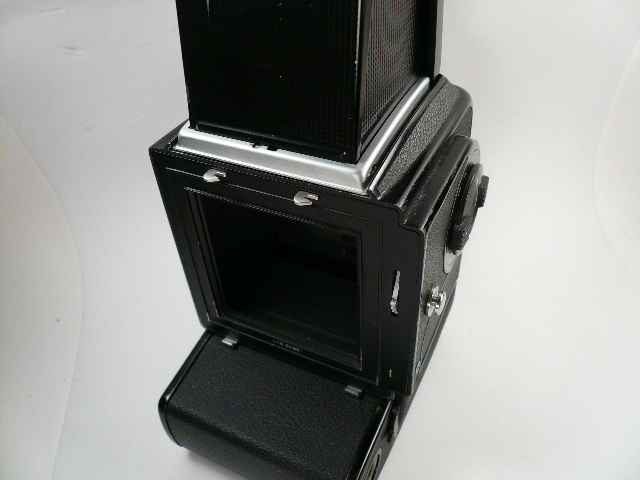

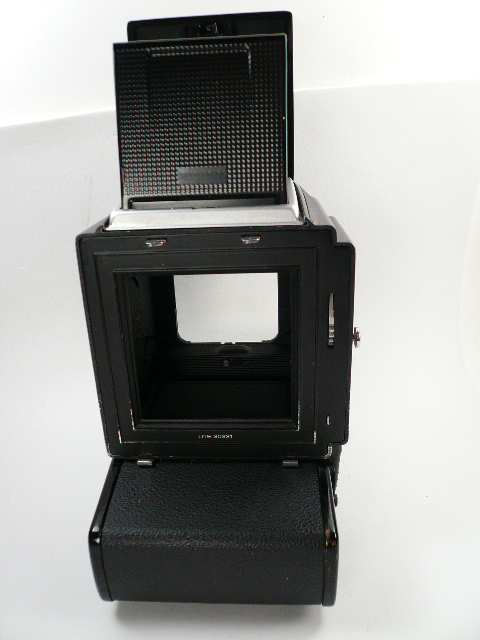

And last data point is, the back can not be mounted because the gear mechanism which advances film by engaging to back gears is not flat. (I will be posting pictures shortly.)

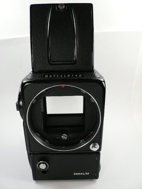

I also attached some pictures of the cameras back and front.

1st is the battery fully charged/fresh? I sounds as though it doesn't have enough oomph to complete the cycle. It's possible for a battery to check as good but not be able to provide enough current to operate the camera. I don't remember if there's a spring assist or not but if there's a lacking of tension it would contribute to the problem.
The light trap could be loose on it's shaft, I've seen this as a common problem on C cameras & think it may carry through to the newer cameras. The light trap is aluminum sheet that relies on tension to hold it in place. If it loosens up a bit it will rotate on the shaft & intrude into the film aperture. The fix was to get the camera to a ready to fire position & adjust/move the blind to the correct position & "adjust" the tension.
If you just bought the camera I would seriously consider returning it for repair on refund.
Q.G.
Jul 23, 2007
5,535
Netherlands
Resetting the thing using a screwdriver does not move the entire mechanism into the correct state.
You're camera needs a repair.
Will be the reason this thing was in a batch of Hasselblad items.
The dial does not stay in "S" position. It is not supposed to.
If you want to "R"epeat the "S", use "SR".
