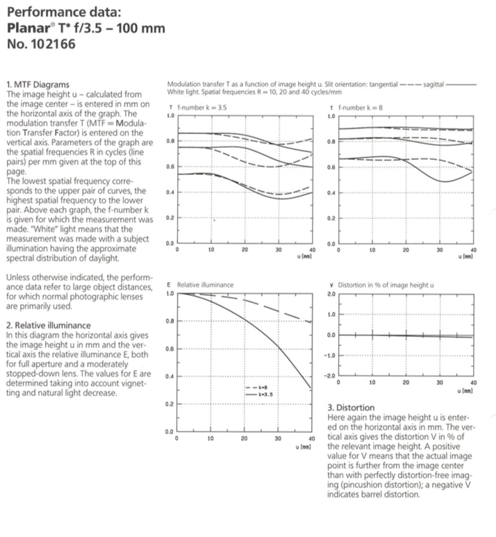

The definition: https://en.wikipedia.org/wiki/Optical_transfer_function
An explanation of how to read the plots: http://photo.net/learn/optics/mtf/
Basically the closer to a horizontal straight line the better.
First take a look at the CF 80mm lens and the CF 100mm lens. The modulation transfer curve is flatter for the 100mm lens, which is much much sharper.
Then compare the SWC and the 40mm modulation transfer curves.
Modulation transfer curves are hard to learn to read and understand, but they provide scientific data about how a lens should perform. Use these for comparison, but one must remember that these curves are only part of the lens performance and should not be the be all end all for choosing lenses.
