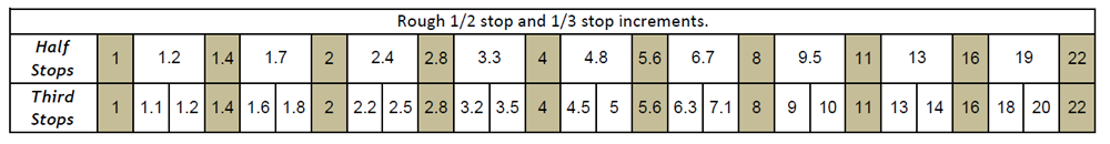

The attached image has a 1/3 stop and 1/2 stop scales.
As 'artonpaper' suggests above, just round to the closest half stop when you meter for thirds.
