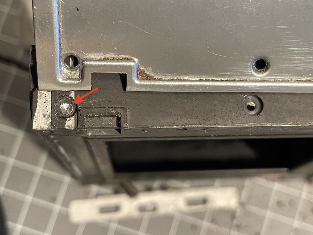

Problem 1: a seized/stripped screw on the outer shell. With hindsight, I might have been able to release the inner plate with a but of bending of the outer shell, but that might have made things worse. Anyway, I've drilled the screw and now need to find somewhere with a precision drill press to drill out what remains of the screw and retap the hole. I'm in Melbourne, Australia. Does anyone know who might do this sort of work? I expect that I'll have to put in a slightly larger screw.

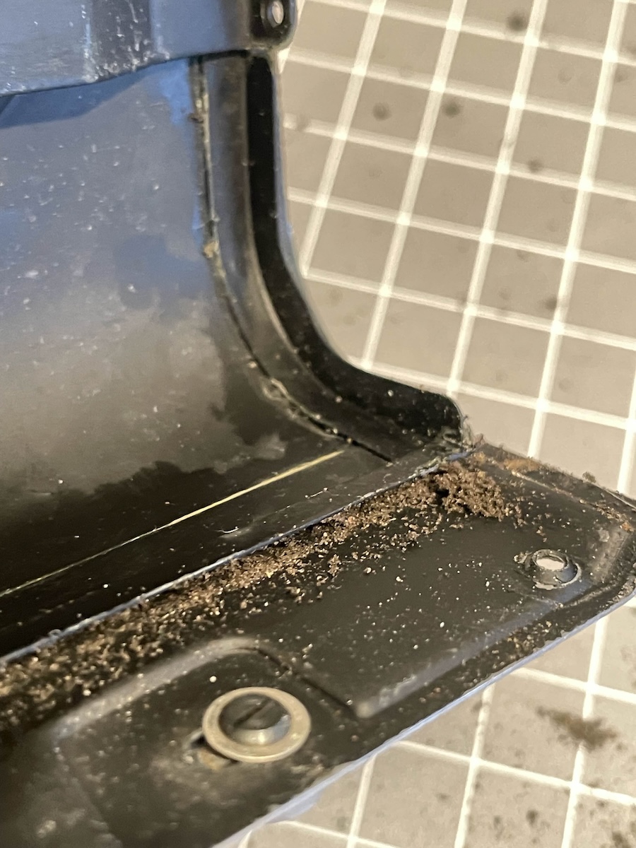

Problem 2: After removing the outer shell to reveal a whole bunch of black dust fell out. There's far too much of it to be just accumulated gunk, so I'm guessing that is the remains of some light sealing material. There is a strip of light seal in the service diagram for the A12 which looks much the same shape as the dark slide light seal foam, except without the backing. Any suggestions of what to use?

Problem 1: you can take a small drill bit and in essence hollow out the existing headless screw. Looks like you have a nice center divot. Use a bit about 2/3rd diameter of the screw? Then collapse the outer 'tube' that remains inward and pull/push it out of the way. Or you might even be able to take a small screwdriver, jam it into the hollow, and back the screw out.
You might need to go to wider diameter bits. Although this isn't 'best practice,' screw threads do have a little excess material and will work fine in most case if your drill bit reduces them slightly. And you don't need absolutely perfect threads at all points in all directions. A little nick here, reduction there... This isn't a life or death assembly (oh geez, did I just way that to a Hasselblad guy?? my apologies. yes your camera is amazing!!! :smile: A little light duty thread lock might help reduce any anxiety if you have gone into the threads themselves a bit.

Problem 1: drill a small diameter pilot hole and use an easy out to remove the screw. An easy out is a conical left hand threaded tool designed for exactly this type of problem.
Thanks Sirius. Easy-out brand doesn't go quite that small - not that I could find. I'll try a 1mm left-hand drill bit first.

OK, it's taken a while but I have the screw problem fixed.
The screw was thoroughly seized. I had hoped to back it out with a 1mm left hand drill, but ended up drilling the hole out, filling it with JB Weld, drilling to 1.25mm and tapping a new thread. Getting the various drill bits and taps took a while.
One lesson, although two part epoxies say full cure in 24-48 hours, my test piece hardened noticably over three to four weeks, so the long you can leave and epoxy fill before tapping, the better.
