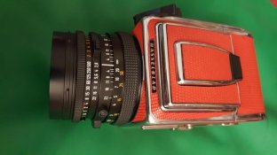

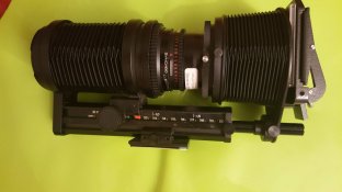

Got a automatic bellows extension #40517 with a S-Planar 135mm f5.6 T* C Manual focus lens
for my newest toy a Hasselblad 500 C/M:
I am a complete newbie and now my silly question is how to use it for macro photography? Searched for manuals but found only things like this: http://www.hasselbladhistorical.org/pdf/lds/CF135.pdf which are not answering my questions.
What is the meaning of the markings here and how to use it:
https://thumbs.worthpoint.com/zoom/...ellows_1_cc331e206253d4c4028b70b4df5c2606.jpg
45 until 5.6 is aperture....
125 to B should be the shutter speed, but this lens has no shutter so far I see, which rises for me the question how to photograph with it...the bellows extension is installed at the Hasselblad 500?
The letters V, X and M I do not know....the device next to the M is the flash connector (I think) but the other two metal levers I do not know, too.
Edit: https://thumbs.worthpoint.com/zoom/...ellows_1_cc331e206253d4c4028b70b4df5c2606.jpg
For what are the numbers in red and the two levers, too?
The other thing is I do not want to play around with it and not knowing what I do....because I do not want to brick something....

I do not know the answers to your question, however when putting multiple lens attachments on the Hasselblad, add the closest one first and the outer on second. Then remove the outer one first and the inner one second. Removing both at once can cause jams and damage.

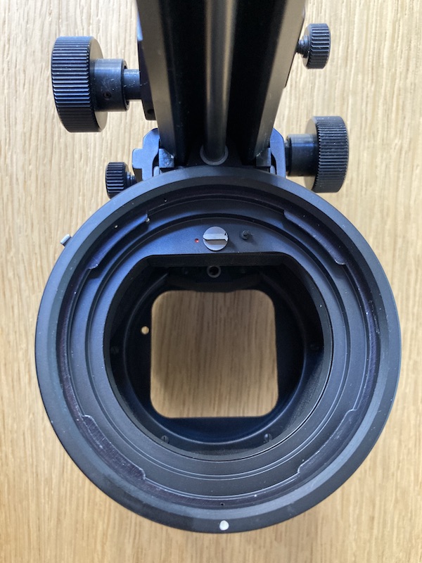

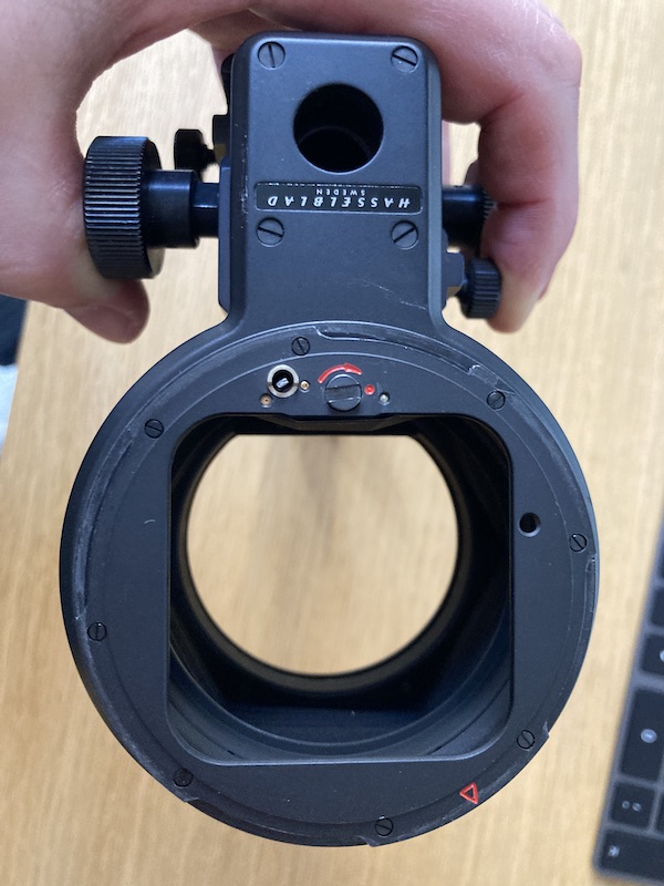

Would you mind checking the following for me:
do the sides A and B (if you remove the lens - PLEASE ensure everything is cocked before doing this and if you are not sure, don't do anything) look like this:
Side A (camera) :
Side B (lens) :
This shows the linkage from the body to the lens. The shutter release of the body will trigger the lens, in the same way as it does with your 80mm lens directly assembled to the body.

Next test, if you have removed the lens:
mount the bellows to the body. Does the "screwdriver" on B side turn when you press the shutter and rewind?
If not, something is broken, I suggest you send the bellows back to the seller.
(Edit: the auto bellows actually *has* mechanical connexion in C)
