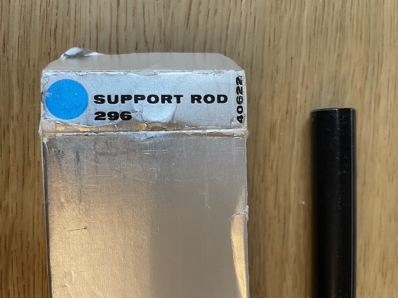

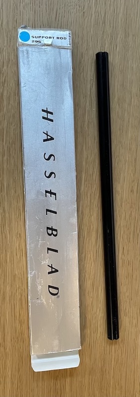

Do you mean, this?
it was / probably still is / should be available as a spare part. Note there are 2 versions, a short and a long one. This is the long one.
Hope this helps :smile:

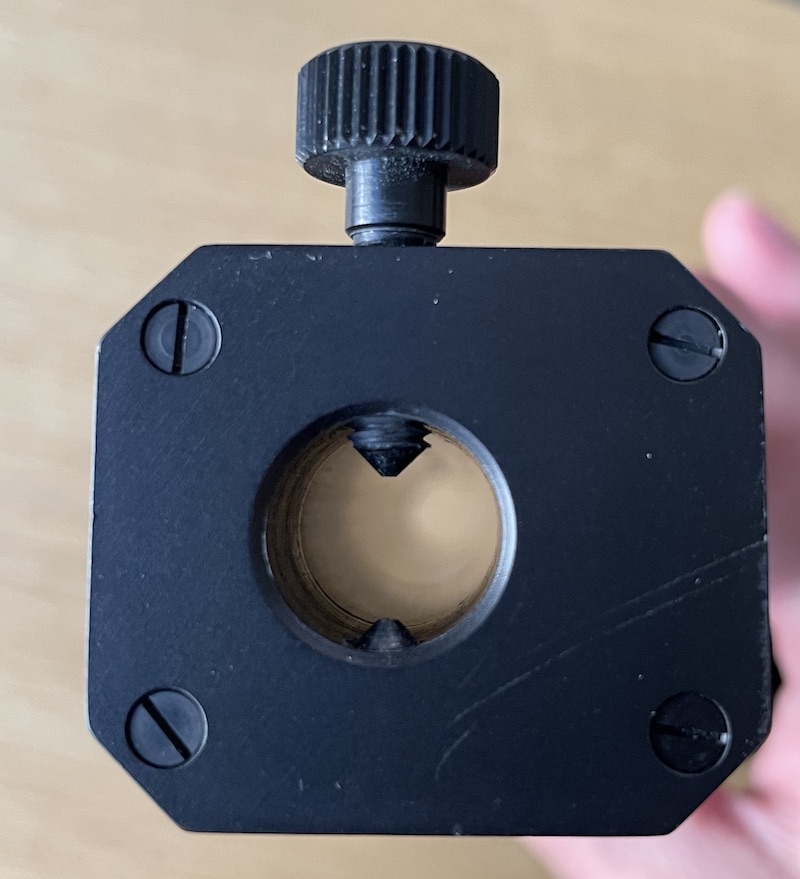

Is there any complicated reason for that slit in that rod? Or could not a slightly modified aluminium or brass rod be used instead?
ToothyWeasel
ToothyWeasel
Jun 26, 2021
8
Rhode Island
I believe that is for the screw that tightens to stops it from moving. I don’t think there’s anything special about it which is why I was wondering if there’s any repayment someone has used before

Just stop by Home Depot or Lowes, etc, buy a duplicate size mild steel rod from hardware and run a power hand grinder down it in a straight line to grove it
If you do no know how to use a grinder or have access to a Machinist mill, ask your local high school or collage machine shop teacher to do it for a few bucks.
Of course, you could just pay a machine shop to do it for you and apply whatever finish you like, yourself.
Yes, brass and quality aluminum rods should work, but what ever length you settle on, make two, for for sale or as a spare.
