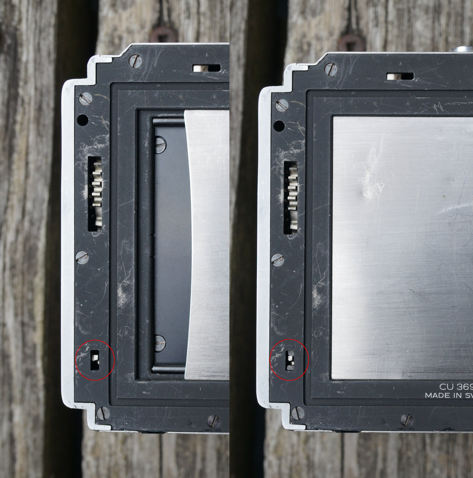

Here is the matching interlock on the back (circled) that prevents the key that extends out the back when the shutter is pressed:
You can see above, there is a metal fork that slide around the interlock pin to prevent the key from entering when the darkslide is inserted completely, This metal fork/spring, along with the one to prevents you from removing the back when the dark slide is not present, is easy to lose when you replace the seals, as once the back plate is removed, these 2 springs will just fall out. You can easily check if it's still there and working.
As for the counter returning to 1, it's probably just a clean an lube issue, these "C" backs are from the 50's, this one is from '57 (65 years old!), grease and lube do not last that long.

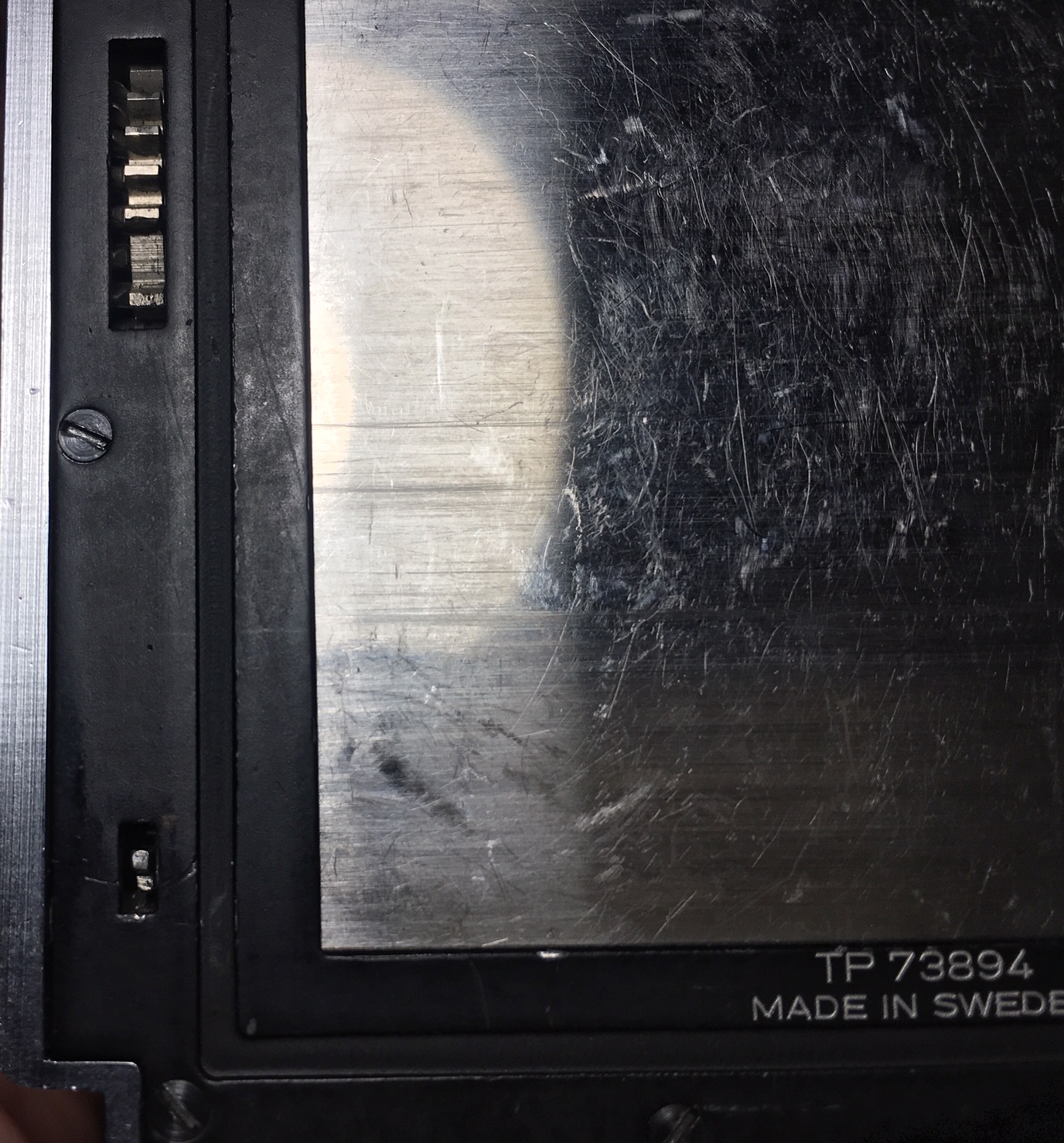

Here's what mine looks like:
I don't see the forks like on yours at all.

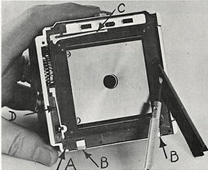

For reference, here is a picture of the C12 back with the plate removed:
The spring labelled "D" is the one you seem to be missing or displaced.
The "C" spring is what prevents the back from being removed if the dark slide is missing
The "B" parts can also fall out and be lost when you remove the plate, they are the springs that hold the bottom of the back against the camera body.
Note the "D" spring on the newer A12 back is of a different design.
