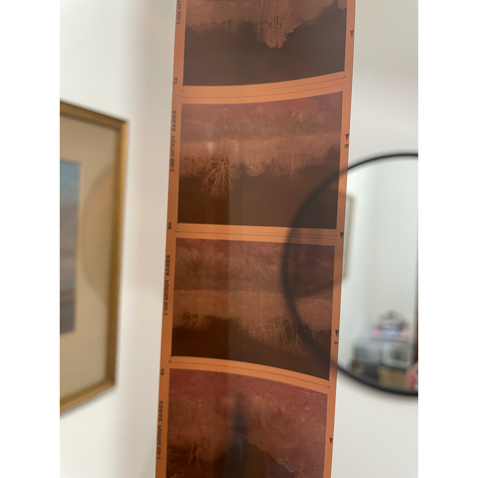

Hi, just got an a16 back and the frames all look fine and quite consistently spaced. However there’s these strange lines between each frame, anyone got any ideas why these are there?
Thanks

I think it's a thin light leak at the upper edge of the film holder. (I've seen them on some of my negatives.)

As far as I understand there is no light seal at the top is there? Thanks Ben

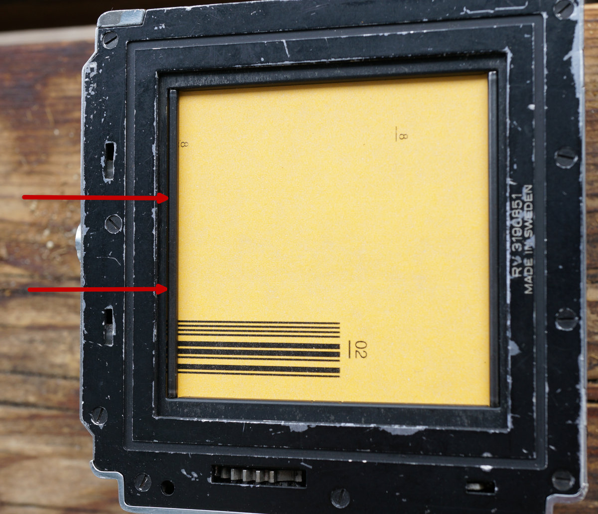

This is what the film gate looks like (A12 instead of A16, but the same idea).
The rollers define the top and bottom of your frame, which is why the corners have that small hook. But light also leaks past the other side of the rollers (red arrows) on some film backs, which results in those thin lines you see between the frames.
It is usually less visible on the A12 as the film starts to arc away from the roller, but on the A16, the film remains relatively flat on the outside of the rollers.
You can check your film back by putting something bright/reflective (like the back side of the paper leader) and see if you can see the film on the other side of the rollers.

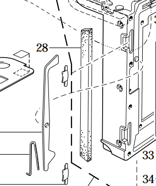

There is the seal at the dark slide, as everyone knows, and there is some other light seal material in the back that also degrades over time - and practically never gets replaced (you'd need to take the back completely apart.
See part marked 28, which is labelled as a light seal. I figure that's no good, anymore. so it lets in that tiny line of light.

It is not a light leak.
It is light that if focused onto the film plan from the lens. Inspect the detail in those slivers, you will see that they correspond to the continuation of your image top and bottom. There has to be a gap between the rollers and the film gate so they can spin freely.

If that was the case, why would there be nothing between the image frame and the thin lines of exposure between the frames? Light isn't quite that cooperative.

The roller (as pictured in post #4) blocks the light between the edge of the frame and the thin line...

Ah, now I see you're right. That's good, then. And what I said was the cause is actually impossible with a 645 back, since the line doesn't even come close to the outside of the back (it does correspond with the location of that roller, though).
