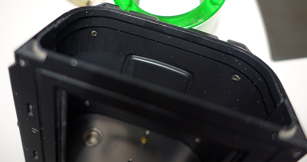

I've acquired an A12 back (new style, with the darkslide holder). I'm not a big fan of the darkslide holder--I don't like the look and it takes up a bit more space in my bag, which is already a small bag for a Hasselblad kit (Hadley Pro).
Does anyone know of any way to remove the darkslide holder without ruining the back? (And is there actually leatherette behind the holder?). I obviously don't want to do trial and error here--I'd appreciate knowing if anyone has firsthand knowledge of this.
I realize the other option is to sell the back and buy another. But I've been having a really tough time finding a nice A12 back in black. I really like the look of the "black dot release" backs without the holder, and I have one of those (I also have a slightly more beat up "12 release" back I wouldn't mind upgrading...).
I'd like to find more of the "black dot release" backs, but I just don't see them in nice shape too often anymore. And if the dark slide holder comes off easily then that solves that problem!

The back will peel off, but before you take that step you need to think this out. All the Hasselblad backs I have came without dark slide holders. Many times I misplaced, lost or bent dark slides when I took them out and put them or thought I put them in a safe place in the camera bag. As a result I purchased and installed dark slide holders on every one of the backs that I have. If a dark slide holder attached to the film back is such a bad idea, why did Hasselblad eventually start building the film backs with dark side holders? You should really think about obtaining a larger camera bag before you risk damaging the film back and wasting someone else's well thought out effort.

Thanks for your reply. Have you successfully peeled of the holder before (or seen someone do it) without any damage to the back? Did you/your friend just use blunt force and pull it off with your hands?
Please remember, this is the newer back with the darkslide holder built in--not one that had it added on. Do you know if the film slot holder remains behind or is that part of the holder as well (I can't quite tell when I examine it)

I more or less agree with Sirius on this, my backs don't have the holder either and I generally wish they did. I've not bent any slides, but I've occasionally had to take one out of another back so that I could take the back off the camera and couldn't find the slide for the "in use" back. Keeping track of the loose slide can be a PITA.
Yes, the holder is a bit clunky, though the built-in ones are a lot less clunky than the aftermarket ones (IMHO).
If you're concerned about cosmetics, the back won't look better after it's off and probably will look a great deal worse, I doubt that it will peel off cleanly.

I sent Hasselbald a quick e-mail asking the same question, but I also asked on photo.net and from the couple people I've heard back from here and there, it sounds like it's not worth risking trying to peel off the back.

If the slide holder looks like the Chinese knock offs, then the tape is probably a 3M product. Meaning it will be a beeotch to remove, not impossible but...

Just in case anyone is interested, here is Hasselblad's response to my question:
"Early models had the Dark slide holder attached with a strong tape only
and the Leather was intact under
Later the Slide holder was screwed on to the back from the inside
You can check this by removing the Film holder and the Dark slide
If you can see 4 screw heads on the inside of the Shell, It is a later
model
In that case, removing the Slide holder will mean that the screw holes
will be visible
Best Regards
The Hasselblad Reception"

Unfortunately I won't be taking the holder off--I don't want a film back with the screws visible. If it was held on with just tape I'd consider removing the holder. I'm going to see if I can just find a nice black dot back and sell the one I have.

The slide holder is screwed on!! Four small screws on the inside of the magazine. Two on the top and two on the bottom.
