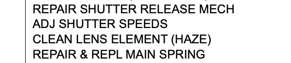

It might not be the back. I had a similar problem with and SWC, it turned out to be a shutter release spring. So whoever you send it to (I'm sure there are Hasselblad technicians in Canada) describe the problem--they might want you to send the body, too.
