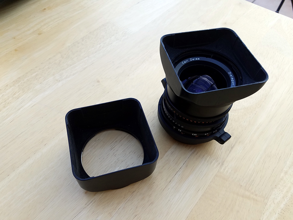

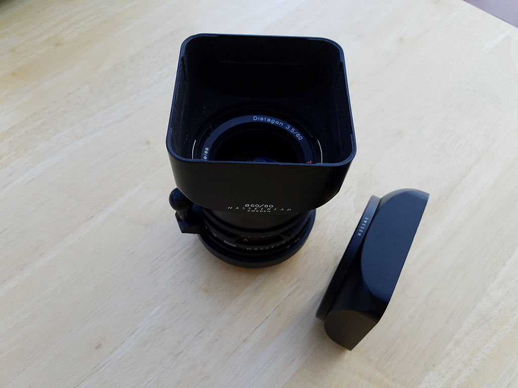

I'm wondering if anyone has actually tried using an 80mm hood on a 60mm lens and if they had any vignetting in the film.
The size of the 80mm hood is crazy big on the 60mm.
Here's with a regular 60mm hood.
The frame size is 49x37 and you can see vignetting already on the corners. On a 6x6 full frame it'll definitely show, though I didn't see it in my viewfinder.

The size of the 80mm hood is crazy big on the 60mm. View attachment 179609

Yes, I shot at f/3.5. However, some of the vignetting could be the inherent vignetting from shooting wide open.
