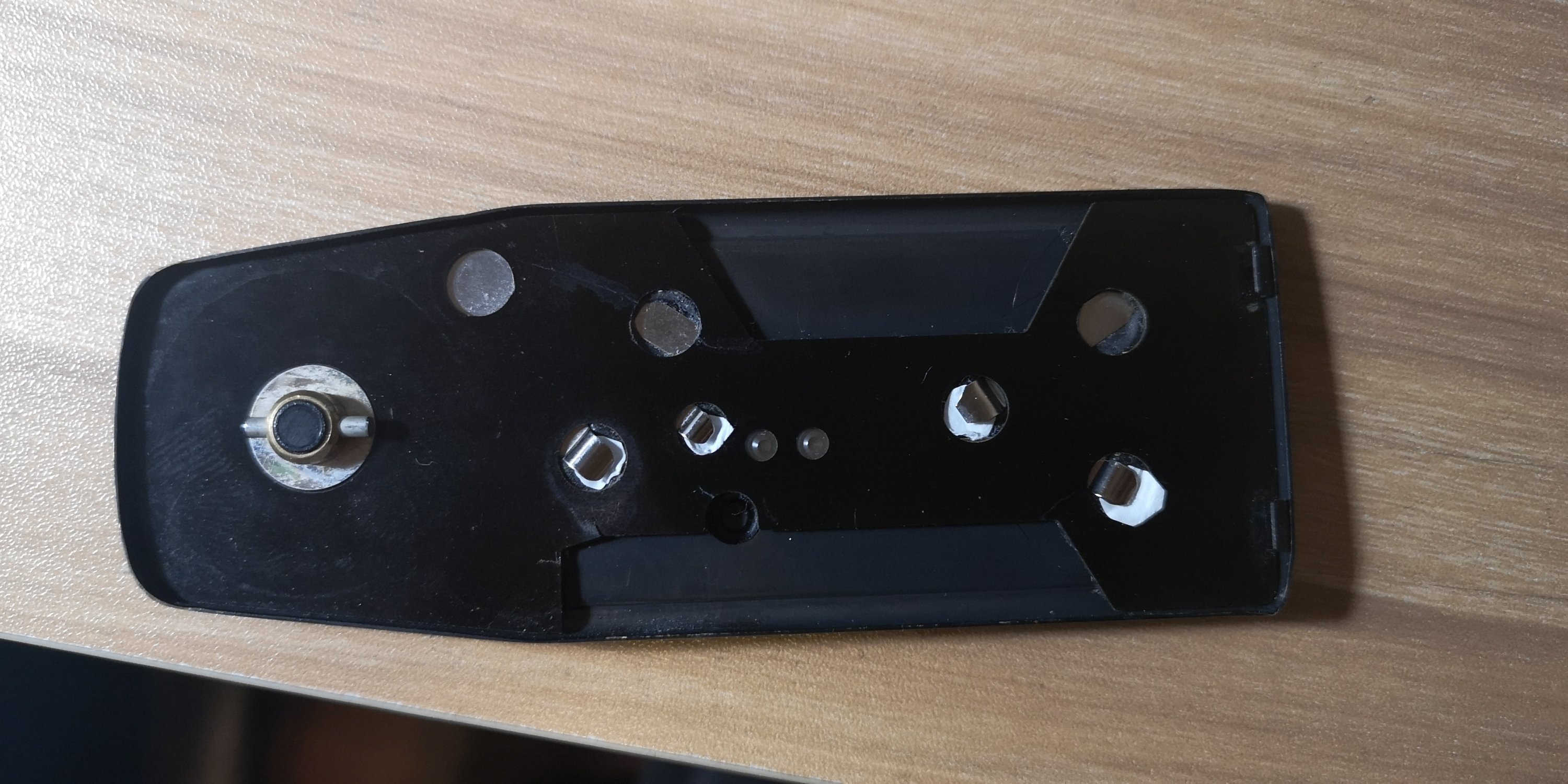

I just bought a 553 ELX, and I found this problem too
that is how I fixed this short problem: cut a little pice of paper, and but it under the battery negative contact
that's work very well, and camera doesn't get hot anymore. IMG_20191120_141005.jpg
that's work very well, and camera doesn't get hot anymore.View attachment 234981
It sure is nice to have such a simple fix. My 553ELX will never suffer from this "simple to fix" problem. Why? Well, it seems all my camera malfunctions are always major and require at least some disassembly to fix. Just my luck I guess.
