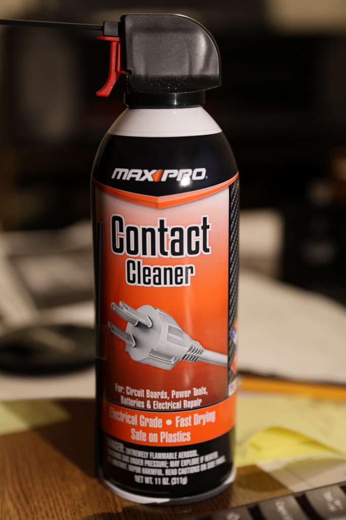

If you are convinced that the back is the problem then I would take the side cover off on the handle side and do nothing but flush everything with an electrical contact spray and put cover back on and try it. I think you might find a video on how to take the side off somewhere. If that fixes it you can take the side off again and sparingly oil different levers and whatever looks like oil will help. Don't use WD-40, uses a sewing machine oil. Do this only if you plan on buying a new back anyway.
I do not recommend the use of electrical contact spray. Some of these have formulations that do evil things to plastics. Also, spraying complex photographic mechanisms is typically not a great idea because it spreads the sprayed material all over the place indiscriminately.
A better choice is to to carefully clean the affected area more surgically with naptha (lighter fluid). I use pipe cleaners or low loft industrial q-tips for this.
I agree that electrical contact spray is a very poor choice. Use a surgical approach with pipe cleaners or industrial Q-Tips.

The contact cleaner I use leaves no residue and is safe on plastic. I use it often when fixing copiers which are plastic, electrical and mechanical. I can spray hard to reach roller bushings. I use this to clean shutters and blades without having to disassemble them other than the top rings. A few drops of sewing machine oil in targeted areas has worked out great for me. I do take the elements out.
This is what I buy for my business at about $6.50 a can. This has saved me so much time troubleshooting and sometimes that's all I had to do to fix a copier or printer.
