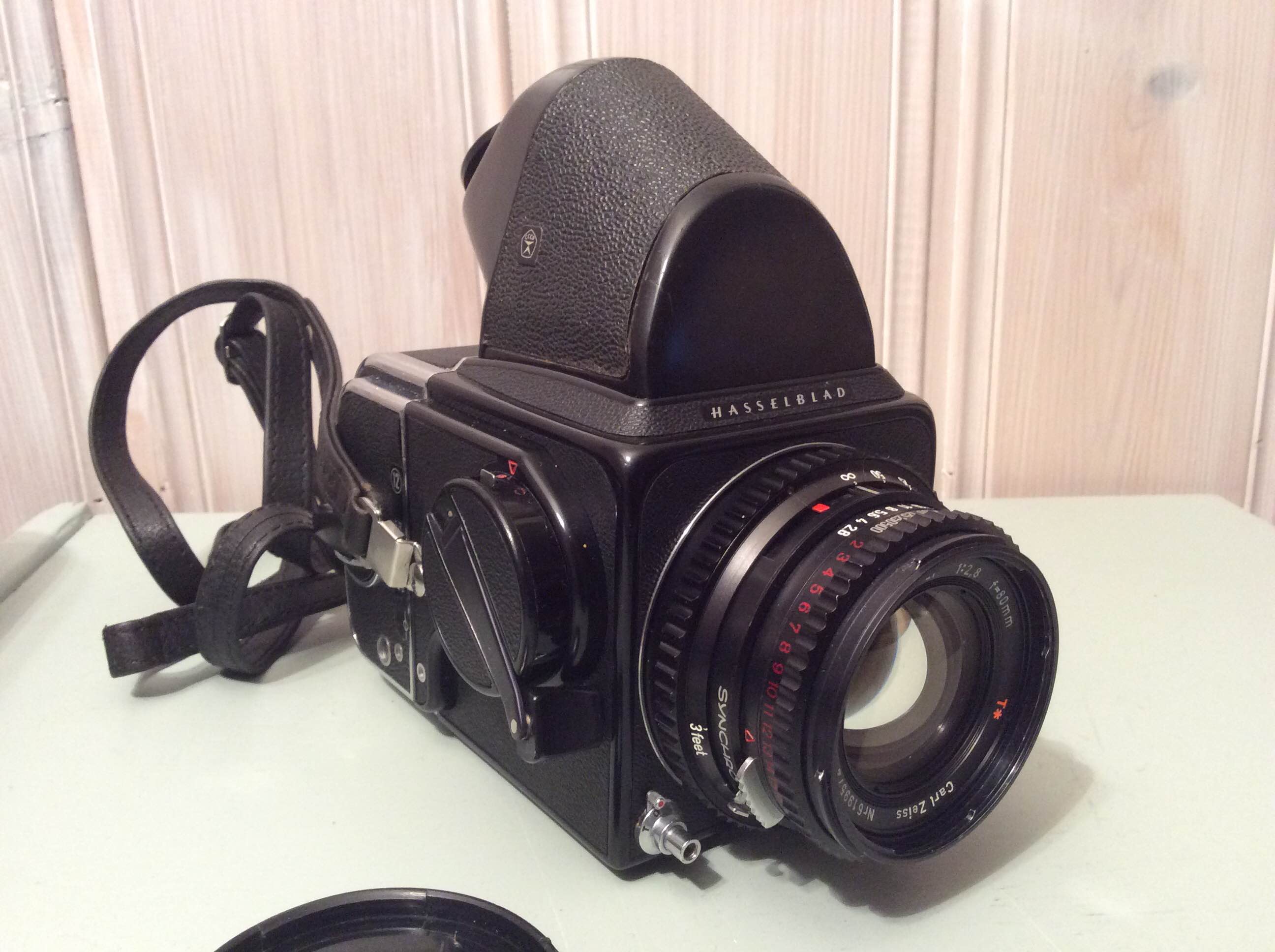

Ive been keeping track over the last year or so as I sold off one of my 500CMs and they can be found for around 700USD in good working condition. Im located in Norway and am thinking of selling my 500cm. If you are interested, shoot me a pm. Its my user camera that I am thinking of selling and its in good condition with a T lens:smile:
