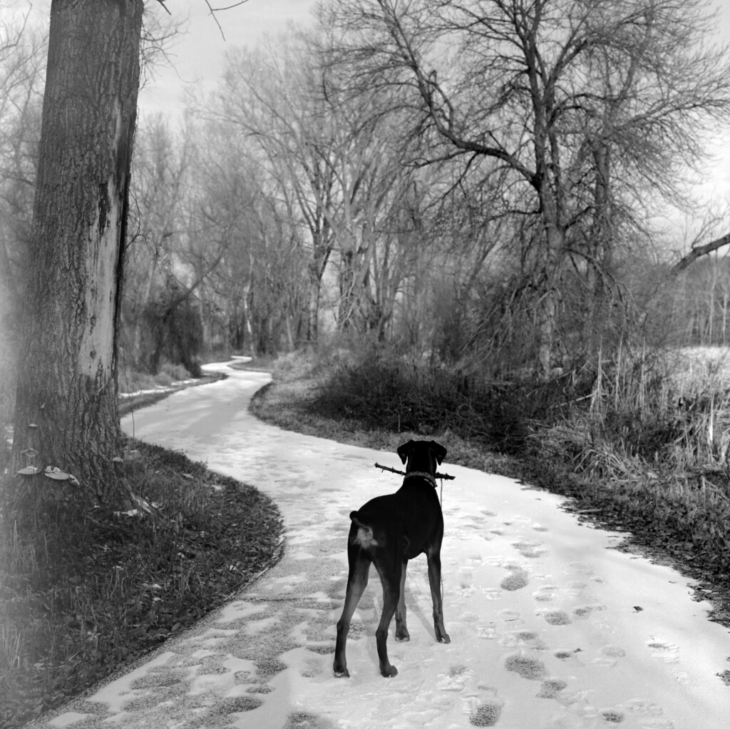

Interesting in that I once had (what I thought) was a light seal leak. The below photo shows the leak on the left of the photo. I replaced the seals on this magazine, and never had the problem again.

I think then the issue would be the film back. I noticed heavy corrosion and yellowing on the film back as I was inspecting it this morning

I don’t think it is light piping / loosely wound roll, you would see the effects of that on the rebate (black unexposed area around the image) and I don’t see that here.
Good point. Light piping or loosely wound does not address the over exposed areas in the middle of the negative.

It is probably the dark slide seal.
They appear on the right side with a shadow up against the rebate, or on the left side right up to the rebate. It depends on the nature of the leak.
If the leak come is at an angle and exposes the right side of the image, the lip between the dark slide slot and the film plane casts a shadow that you can usually see on the image.
If the leak comes in at a shallow angle and exposes the opposite side, you essentially get a big shadow that looks like the above, and a reflection from the lip on the opposite (left) side. You can also see some artifacts at the notches, where the reflection is missing, casing a shadow - although those may be image processing artifact.
Checking the rebate will narrow down the location of the light leak.
That video linked above shows the same left side light leaks, although the sharp streaking one (on the cover image) is not from the dark slide seal. It may be from a gap between the back and camera, but really looks more like a PP job. Don't always believe what you see/hear on YT.
