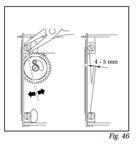

It's not something that can't be fixed. Any body you buy may have numerous issues that require attention.
Body removed from shell, hold that pivot with pliers to prevent it from turning, and bend the top shutter inward until it doesn't "droop" anymore (apply pressure close to the pivot point). I just did this with a Hasselblad EL/M.

The baffle can be pushed back into the correct position as described above, by holding the shaft.
Migration of the upper baffle is a symptom of the mirror brake. As the mirror brake becomes less effective, the shock from the mirror's end travel causes the baffle to shift on it's shaft. The mirror brake consists of a large rubber disk, which both wears and hardens over time (and it's been a long time!), making it less effective. I don't know of a good supply of replacements as NOS stock is rare, and hardened by age.
I've bent a few back into place, but over time, they will shift again. Not a big deal. The other issue is the mirror shock - but I've not noticed anything significant to the resulting image captures, and I still take a lot of pictures without the mirror pre-release. Keep in mind the mirror foam also plays a significant role in mirror shock.
